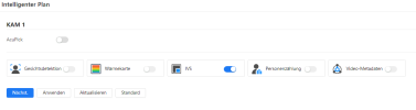

C Chokolinho Getting comfortable Jul 15, 2024 459 309 Germany Today at 5:32 AM #841 The Ze has the latest firmware installed and no long scale mode is activated. I never had that problem with the 3849r1. Attachments ivs.mp4 ivs.mp4 8.3 MB Last edited: Today at 5:37 AM
steve1225 IPCT+ Member Apr 11, 2020 2,045 2,955 Poland/Portugal Today at 5:55 AM #842 Chokolinho said: The Ze has the latest firmware installed and no long scale mode is activated. I never had that problem with the 3849r1. Click to expand... latest - so exactly which one? You must disable AcuPic, reboot and enable Large scale AI models..
C Chokolinho Getting comfortable Jul 15, 2024 459 309 Germany Today at 6:08 AM #843 steve1225 said: latest - so exactly which one? You must disable AcuPic, reboot and enable Large scale AI models.. Click to expand... When I activate the mode, I get even more false alarms.
steve1225 IPCT+ Member Apr 11, 2020 2,045 2,955 Poland/Portugal Today at 6:18 AM #844 Chokolinho said: View attachment 230678 View attachment 230679 View attachment 230680 When I activate the mode, I get even more false alarms. Click to expand... ok, so Large Scale AI models are available, simply you have more false positives on them.. False positives from WHAT? What objects creates them? Any footage / pics of alarms? Also did you have enabled animal detection? I remember that you reported false positives on this scene and didn't answer for any my question..
C Chokolinho Getting comfortable Jul 15, 2024 459 309 Germany Today at 6:21 AM #845 steve1225 said: ok, so Large Scale AI models are available, simply you have more false positives on them.. False positives from WHAT? What objects creates them? Any footage / pics of alarms? Also did you have enabled animal detection? I remember that you reported false positives on this scene and didn't answer for any my question.. Click to expand... I posted a video where the object is recognized on the left. Yes, with that mode I would have even more false alarms. Reactions: JDreaming
steve1225 IPCT+ Member Apr 11, 2020 2,045 2,955 Poland/Portugal Today at 7:02 AM #846 Chokolinho said: I posted a video where the object is recognized on the left. Yes, with that mode I would have even more false alarms. View attachment 230681 Click to expand... it has two legs you can edit minimum object size for intrusion... Reactions: JDreaming, Chokolinho and bigredfish
