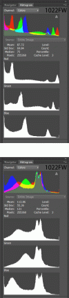

For completeness, here's the Histograms for those two sets of images above.
There's a noticeable right-shift in the (top) 1509 pics ... whereas the (lower) 1656 is much closer.
I'm not sure this really tells 'ya much (except that the metering was brighter in the earlier 1509 which had more sunlight) ... since the scene is different (bummer I don't have 'em side-by-side) ... so the "Mark I Eyeball" is probably a better judge.
Yes, ZE is vari-focal ... both set at zoom=550 (on a scale of 0 to ~2,500) ... but as noted before, the focus numbers are not that close ... about 1640 & 1740 ... so make a slight difference in FOV. And yes, it's an overview camera as shown.

Now that you mention it @EMPIRETECANDY, there is a blue shift in the histogram - the 1022FW shifts to the left compared to 0827FW.
Again, the scene is different (bummer I don't have 'em side-by-side anymore) ... so it's not directly comparable.
