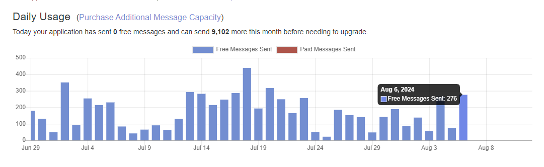

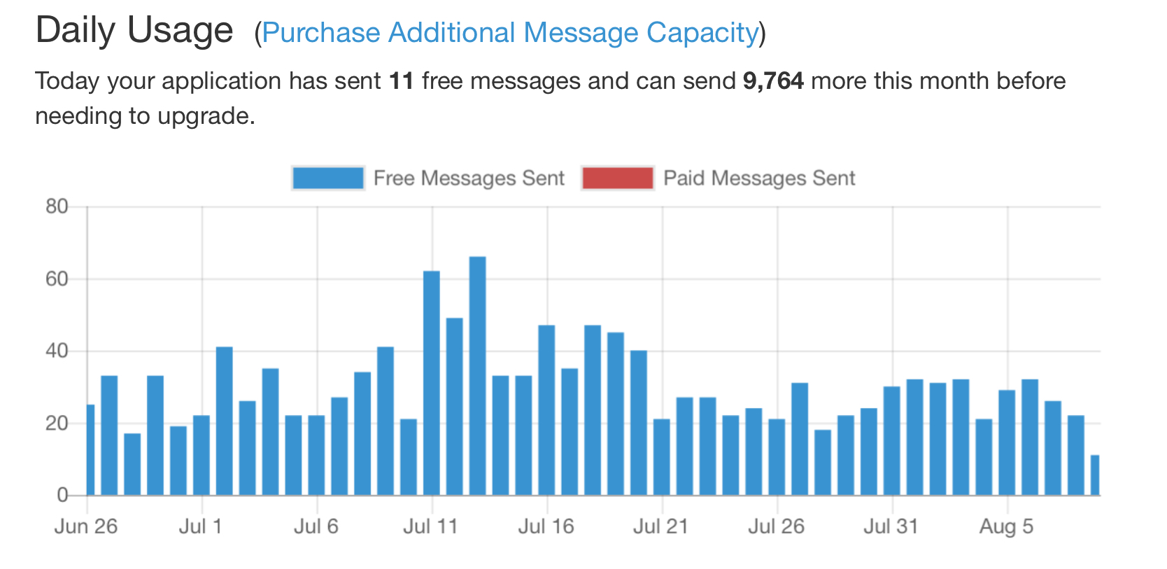

Have you checked your Pushover dashboard to see if the server is receiving API commands? Here’s an example for one of my Application tokens…

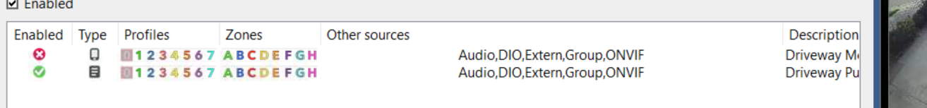

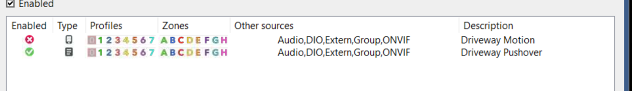

Are you refering to this? the enabled alert is push, all of my camera have it enabled. When I test the alert it says complete but nada
Yes. This looks good.

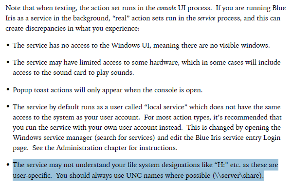

The only thing that happened was my storage drive died but I've since moved the path to the new drive and also changed the drive letter to match.

If you mapped a network drive to a letter, and are running Blue Iris as a service, then you might be running into the following issue described in the Help PDF... see the final bullet.
From the Help PDF, chapter 'Alerts and Actions', section 'Testing the Action Set'.

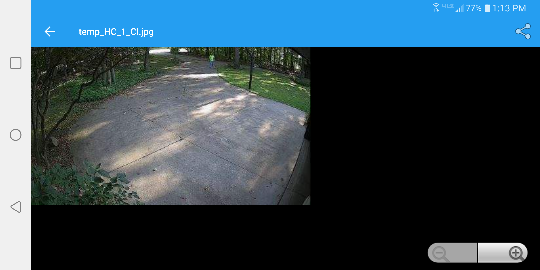

Here is where it ultimately goes after a third tap -- which is evidently to the phone clipboard at a small thumbnail size which can then be digitally zoomed and panned, both quite poorly and not exactly practical on any usable level.
