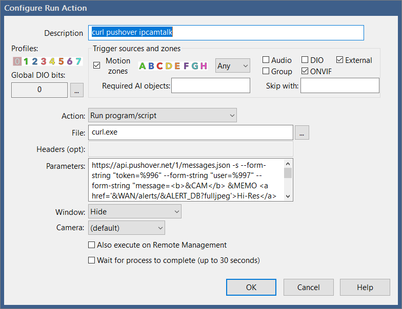

I think I've figured it out... But just in case I'm wrong I want to see a screenshot of your Configure Run Action page.
Like this...

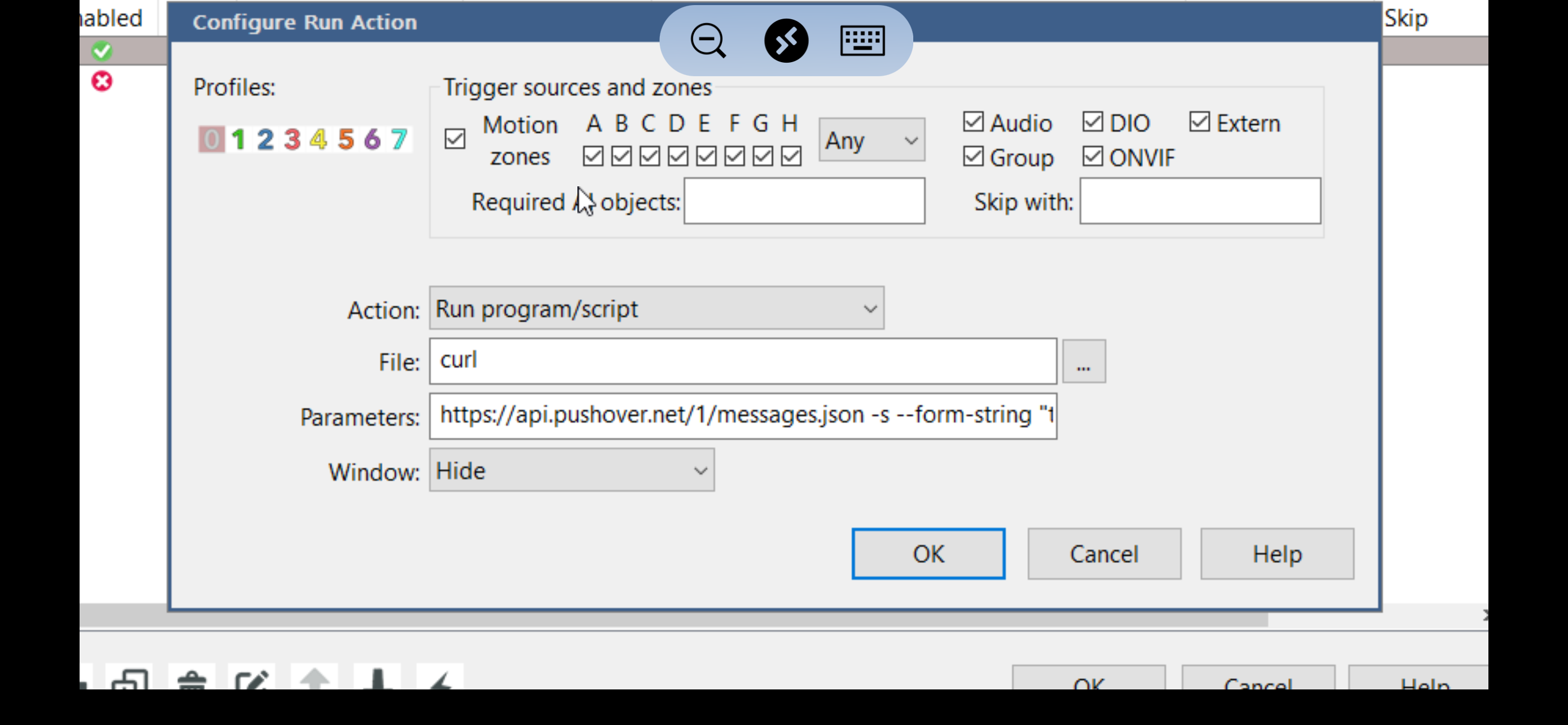

It’s working fine except there is no URL link to click on. If I had swapped user and API key, it would not work at all. Attached screenshot
I basically just get this with no clickable links. Without the macros it gave the lonks
