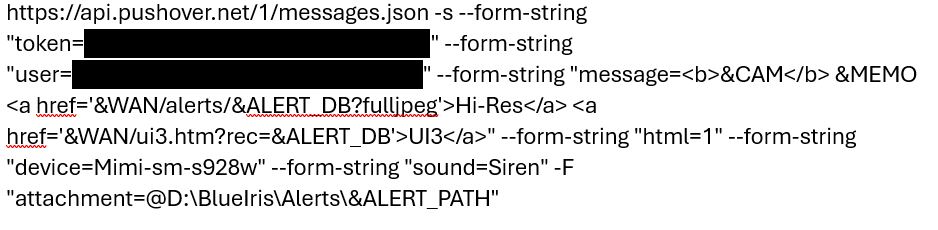

Okay so the syntax is being run in an action set in blue iris. So I am guessing my macros are not configured correctly because I changed the location of folders from the db instead. Will try to revert to default and update.
Few questions trying to get a understanding here why I'm having issues via Pushover:
I'm using Tailscale to connect while I'm not at home and am using the following to test with
-s --form-string "token=redacted" --form-string "user=redacted" --form-string "message=<b>&CAM</b> &MEMO" --form-string "html=1" --form-string "device=motog545g" --form-string "url_title=UI3" --form-string "url=&WAN/ui3.htm?r=&ALERT_DB&m=1&p=Jpeg%20HD" -F "attachment=@C:\BlueIris\Alerts\&ALERT_PATH"
If I try to test an alert via Cam Settings, Alert, On Alert I don't receive anything, originally I did receive two alerts but nothing since, they also didn't have a preview of the alert just a grey envelope.
edit so I've just got it to work again, but it still doesn't trigger a preview image just a grey envelope, also the URL link is pointing to my public IP, I would think it should be hitting my Tailscale IP as the endpoints on there match what my BlueIris server is?
Update, I've got it working, how do I add my wife to the same Pushover that I have or is the best way to do it is with creating a Delivery group and then using the delivery group key in the code? I assume that we would both then need to purchase the Pushover application as well?

Finally got push notications to work- the alert_path macros wasnt resolving so I just reverted all the storage settings to default. But whenever I click on the hi-res jpeg or the ui3 it all just times out in the browser. I am guessing I have something wrong with my web server set-up. any advice? but the alerts are spot on and are working!

The syntax looks ok to me.
When you say ‘test’, you are actually walking in front of the cameras - right? The Action does not work if you are using only the Action Set lightning bolt icon.
To restore the picture, you might try the options discussed in post 655.
And some users have found it necessary to add argument --ssl-no-revoke.
It’s been awhile now, but when I last used TailScale, I recall that I had to enter the BI PC’s TailScale address and BI web server port in the WAN field in the Blue Iris Settings > Web server tab.

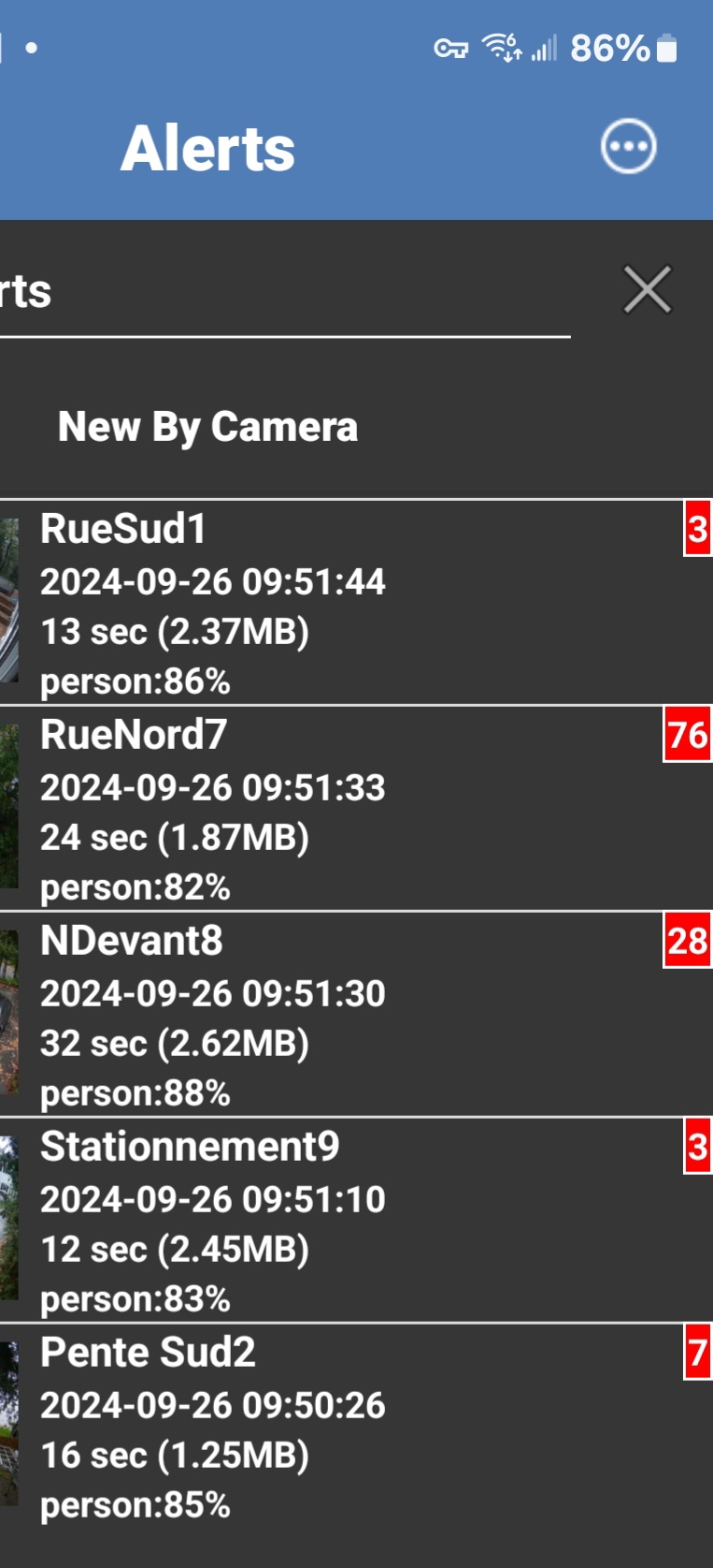

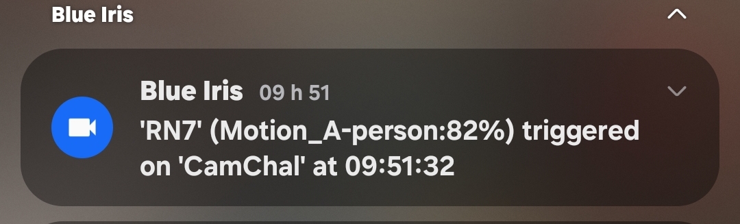

All my cameras have been setup for Pushover as described in the posts found in this very instructive thread. Went for a walk around my backyard.
Photo 1 : The screen capture of the detections made by BI that are shown on the BI app
Photo 2 : The only alert received on my phone
Question : Is photo 2 showing an alert from BI app or PO?
Photo 1 : The screen capture of the detections (All good) made by BI that are shown on the BI app
Photo 2 is a Blue Iris notification.

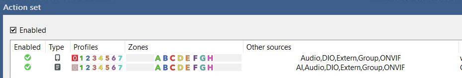

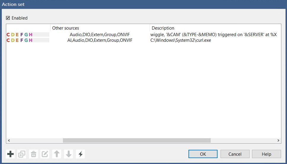

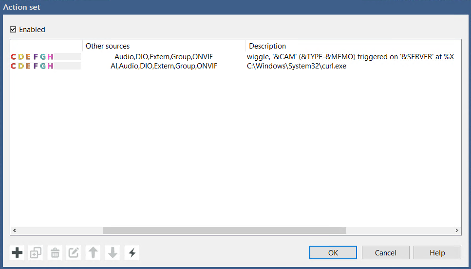

Photo 3 and 4 : Capture of Action Set parameters
Photo 5 : Parameters in Configure Run Action

I did the test suggested in post #1 and did not receive anything on my phone. So something is not right somewhere.
Any clue?

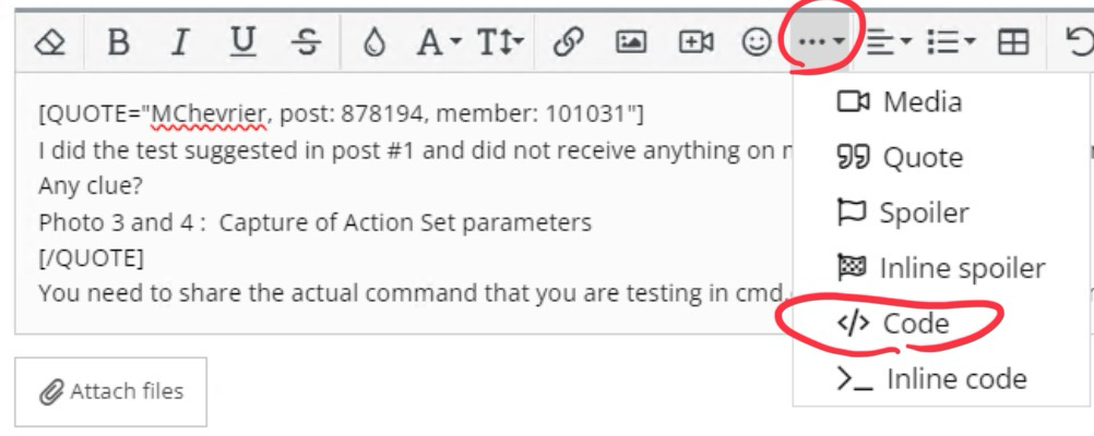

You need to share the actual command that you are testing in cmd.exe. Not a screen grab of cmd.exe, but the actual command text, preferably in a code block.
I did C:\Windows\system32>curl.exe and right here the text found in picture 5 of my preceding reply
If you are using the exact text in your picture 5 to execute the curl command in cmd.exe, then it will fail.
Key Points:
  1. The Blue Iris macros are expanded only when executed via a Blue Iris Action. In cmd.exe testing you'll need to replace them with actual values.
  2. The -attachment= argument must point to a JPG file that actually exists in your Alerts folder.
