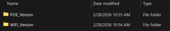

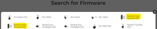

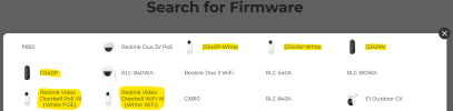

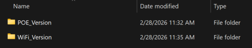

So in updating firmware from ReoLink's site I searched this:

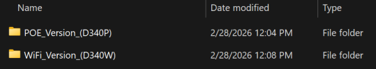

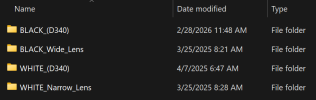

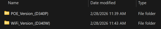

OMG, Reolink and all their versions of Doorbells, haha, 8 downloads...when new firmwares come out...
My Collection:
BLACK (D340)
BLACK Wide Lens
White (340)
Narrow Narrow Lens
Did not find a firmware for the Battery Doorbell
