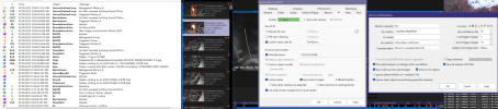

Seems to be starting correctly now, I manually selected Device 0 and the log looks like this now:
But I am getting 0 calls to it. I haven't changed anything since I had 1.0.0.
These are my globabl BI AI settings:
These are the camera specific settings:
Thanks again!

You are trying to do to much with one camera, create a clone of this camera and use it for just ALPR and the main camera for just object detection.

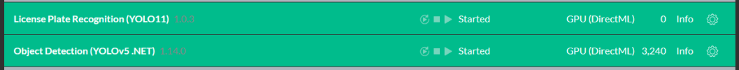

The module seems to be working:
I just need to sort out why it is not getting called anymore.
I am a relative noob to this, I will lookup what cloning a camera is about and see if I can sort this out. Previously the ALPR module was getting called nonstop on everything, now it's not getting called at all.
Edit: OK, Got it, I didn't realize I shouldn't be using the same camera for double duty, I've got a few cameras I will have to clone.
