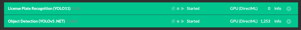

Edit: Not to derail things because this is working perfectly for me, but the number of inference report counts is wonky. I restarted CPAI so I could use Mike's new appsettings (working) but instead of starting at 0 it started in the 7000's which is where it was when I shut it down, and it didn't resume counting from there, it flips back and forth between low and mid 7000's until I triggered a plate reading and then it took 15 images and scanned them all and started flipping between three numbers, the actual count and the old counts.

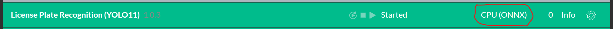

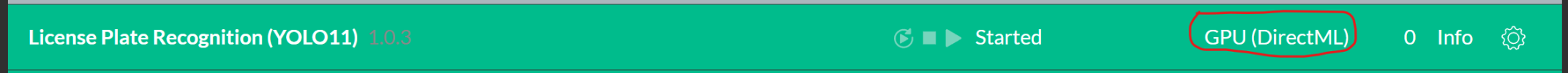

I just released Version 1.0.4, this version uses the original v1.0.0 way of initializing the models using default GPU Device ID 0. One addition is now you can also manually select the GPU Device ID as before v1.0.0 was fixed to GPU Device ID 0.
If the GPU does not initialize due to incorrect GPU Device ID it should automatically fallback to CPU. Check Task Manager and lookup you GPU ID and then go to CodeProject.AI Dashboard and under GPU Device Selection select the correct GPU Device ID
GPU initialized correctly and is using the GPU
GPU did not initialized correctly and is using the CPU
