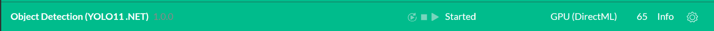

The Object Detection (YOLO11 .NET) module is almost finished, Most likely I will release it tomorrow
ObjectDetectionYOLO11Net Release Notes
Version 1.0.0-DirectML (Latest)
Release Date: January 24, 2025

Verification
To confirm DirectML is active, check module logs for:
Code:
ObjectDetection (.NET YOLO11) setting ExecutionProvider = "DirectML"
InferenceLibrary = "DirectML"
InferenceDevice = "GPU"
