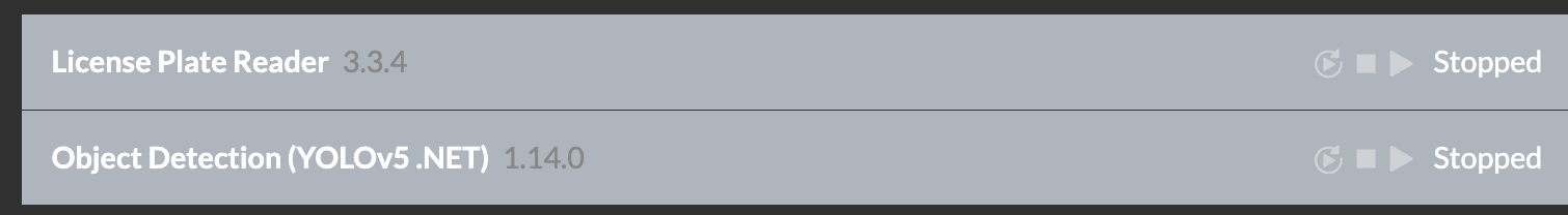

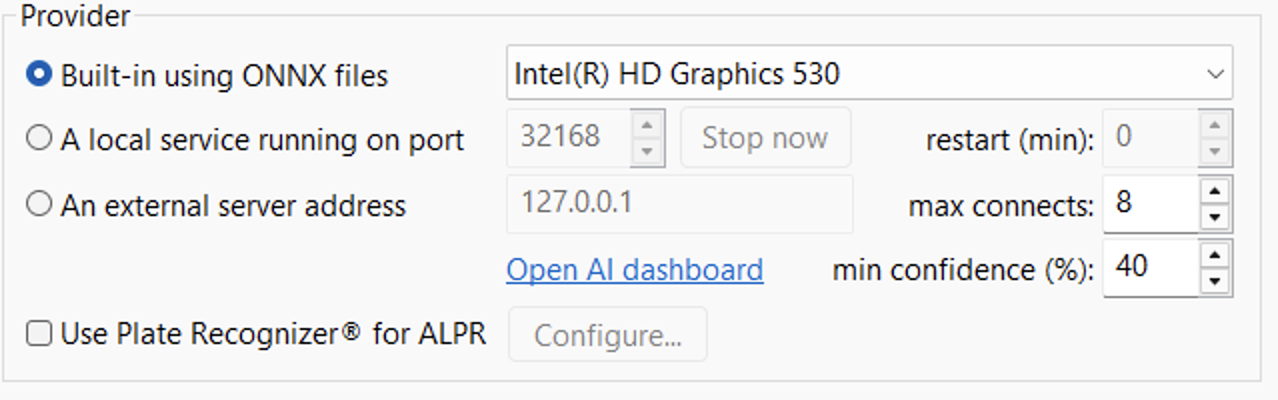

Yeah, I am not sure why the ai_dump stopped working for me. I cloned a camera and one is working with Codeproject and the second ALPR one is working with working with the Blue Iris AI. Both are showing up with that change.
You can try expanding the macro in BI and see what it does.
