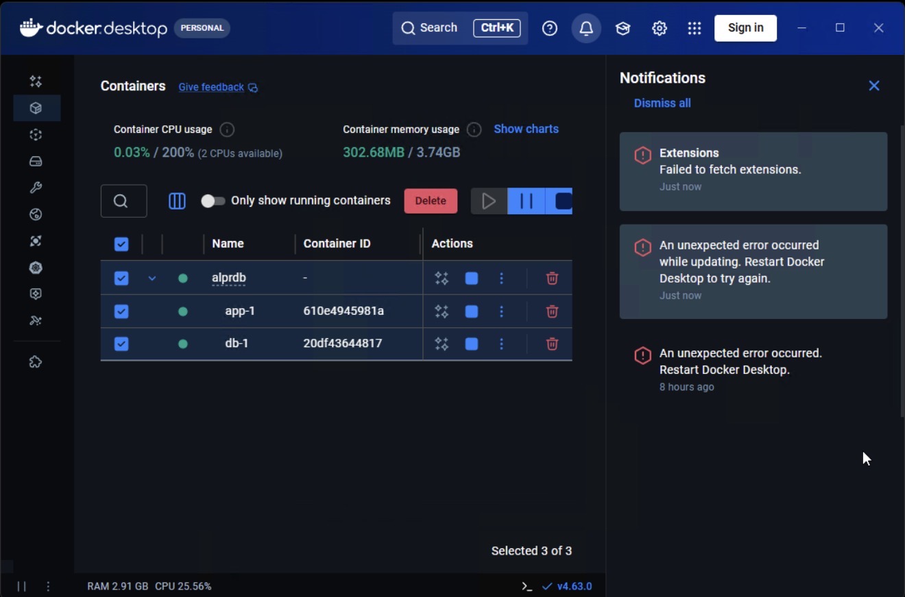

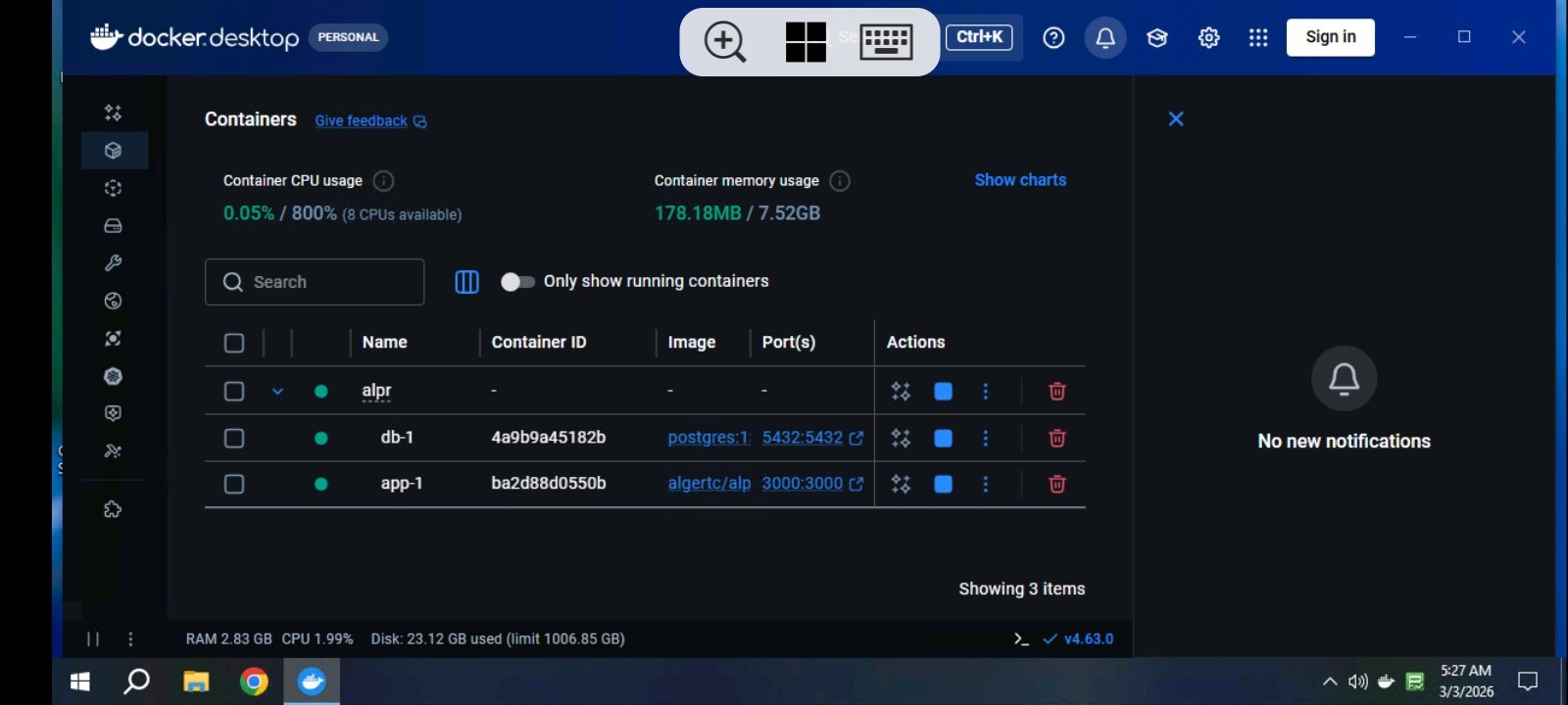

I was running Docker Desktop << 4.62.0, but I just updated to 4.62.0, which is what prompted the restart of the container. :idk:

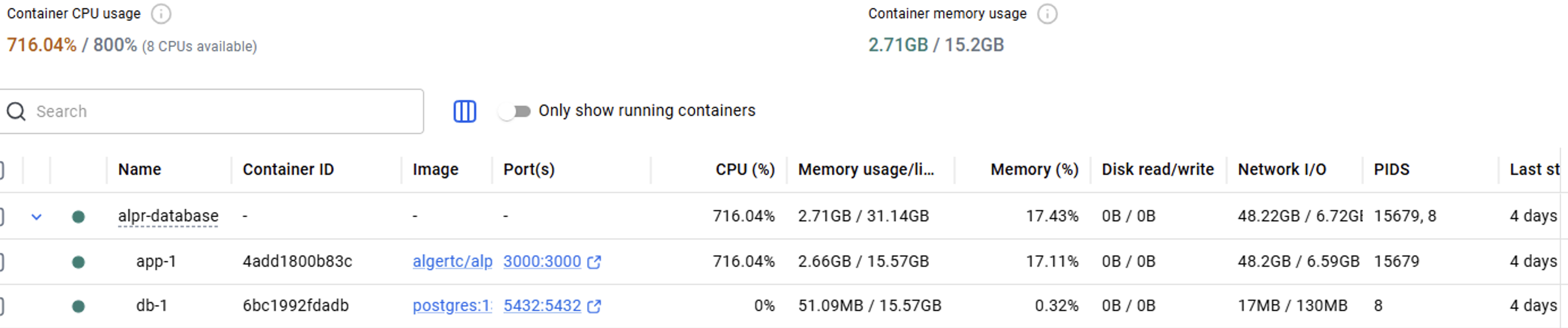

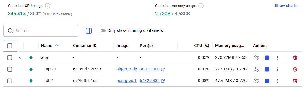

And it just locked up again. Here's the Container dashboard while it was unresponsive:
and then after a Stop/Start:
Memory leak?

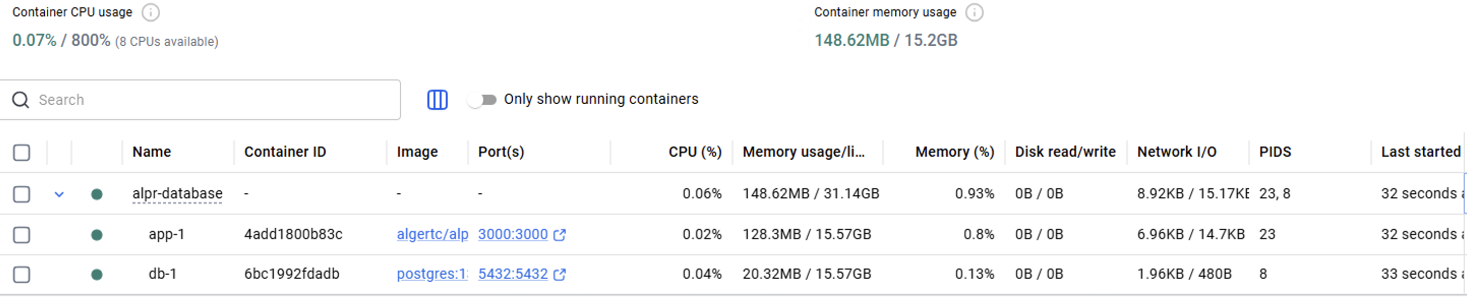

Docker-philes, is there a way to interrogate my container when it's in this stuck state? I can open a Terminal, but I'm unfamiliar with what I can or can't do, there. I did try "top" but it didn't do anything while it was stuck, whereas right now, functioning properly, "top" does report process usage.
From your screenshots, looks like whatever is chewing up all of the cpu cycles is the alprdashboard and not the database. Have you looked at the logs on the dashboard to see what it's doing? Not sure about Windows, under Linux, the dashboard is pretty idle (but maybe you live on a busy street and getting 10k reads a day).
You can try using process explorer (Process Explorer - Sysinternals) and see if that will show what is using the cpu cycles.

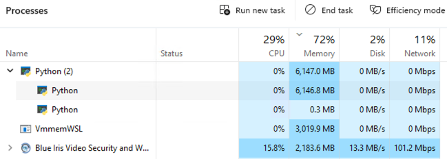

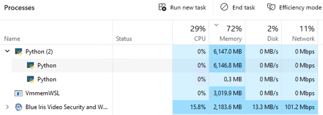

It happened again this morning. This time I looked at the host PCs Task Manager:
and Python is eating tons of RAM. Apparently this is my CPAI server running amok somehow. Restarting the CodeProject.AI Server brought Python RAM usage down to reasonable levels:

maybe try limiting the cpu and mem on your docker compose and see what happens when it hits those limits.
I think that's when the Database dies!
This morning it was extremely sluggish, and barely functional. I have plenty of RAM on the host machine, so it was fine, but the container was up against its limits and really struggling.

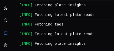

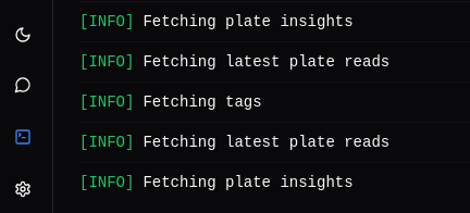

The app is 2 parts, the database and the dashboard. From a previous screenshot, it was showing that the dashboard was chewing up all of the CPU while the database was basically idle. Have you checked the logs on the dashboard to see what it's actually doing?
If things are normal, you should see something similar to this:
I'll have to check next time it goes sluggish, but before it dies, because once it dies I can't get to the logs. Unless they're stored somewhere that I can read them from outside the container or web interface.

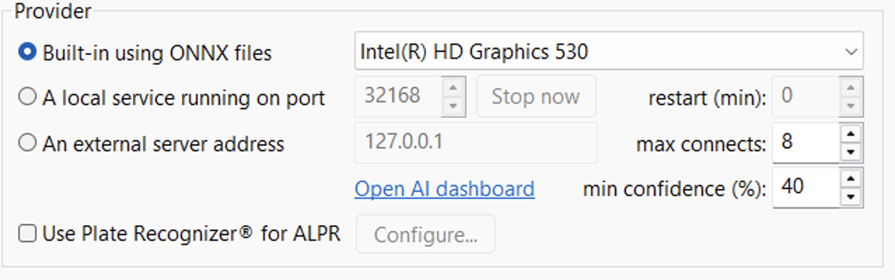

LOL! I just noticed that you're using the built-in YOLOv8, whereas I'm using CPAI and its YOLOv5. I copied the rest of your settings, and it's working, so maybe it's as simple as that one radio button for AI engine.
I'll wait until I collect a Monday's run of plates, and then switch and see if it still works.

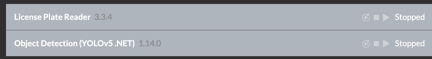

So I just clicked the one radio button to switch from the "local service" (e.g. CPAI) to the Built-In AI:
then turned off the Object Detection and LPR in the CPAI dashboard:
and I'm still getting plates, so I guess it really is that simple! After a few days I will uninstall CPAI completely.
