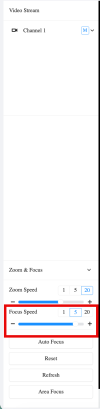

Thanks - is this focus speed section to adjust? I just found the speed that you and Flintstone61 were referring to I believe.

You cannot set a focus for the nighttime during the day as the focus is different for many of us using infrared, so at night you need to have a car stop in the center of the field of view or have someone hold a plate in the center of view so that you can manually set the focus.
You need to set the focus in the GUI to manual and not auto or semi-auto.
It is from the main live screen that you can manually adjust the focus and set the speed to 1 from the default 20.
Reactions: Flintstone61

How do I save the focus speed? If I set it and exit out of the Live Camera view it resets each time I go back to 20.
