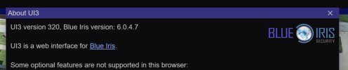

Just to help clarify the issue, my video does not stop as well. This video shows Edge on left and Pale Moon on right. Both are using the HTML5. Notice that even though the error message pops up the video keeps going.
So you're experiencing this on LIVE as well? So far, I've only seen it on playback - and then only if it's 1x. If play back on anything other than normal, it doesn't happen. Interesting.

OK,
#1 No HA on any of my cams
#2 No
#3 Yes on all my cams
#4 No, affects all my cams
#5 No, multi groups and all cameras index works fine.
#6 Yes, I went back to 6.0.4.2 and still had issue. But I did have an EDGE update just the other day.
Pale Moon runs html5 just fine on UI3 and running 6.0.4.7 BI
