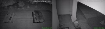

I guess I am just lucky. In the two locations where I have the Color4M-T cameras located (front entry and backyard dog play area) these cameras work better than expected with no added lights. Yesterday I swapped T54PRO-ZE and T54IR-ZE cams in their place, and it wasn't even a fair comparison. The Color4M-T's just work a lot better. These cameras are great in total darkness using their IR to illuminate the scene. If I had those two areas constantly illuminated with porch/outdoor lights, I would probably choose the T54IR-ZE and T54PRO-ZE over them, but for the dark locations where I don't want to leave the lights on, these are better.
Recall I have the 4M-T covering my front door also.
In tight closed spaces they work pretty good.
