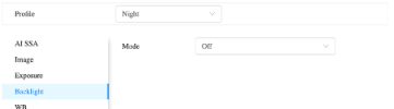

on the LPR, this is what I've set so far for night settings. i have the working mode set to day/night switch. how do I set exposure speed to 1/1000 ? the closest option I have is 1/2000

1/2000 may be fine, hard to say
If you scroll down on the list you should see Custom.
It lets you set a range in milliseconds
0-1 would be no faster that 1 millisecond or 1/1000

There are two ways of doing this...
First are using very fast exposure times (like 1/1000 or 1/2000) to capture only plates..
Second is using WDR trick with much more normal exposure times (1/100 to 1/200) and very strong IR light...
plates are very reflective and should be very over exposure.
Full WDR (with values >= 50) is doing double (and in case of 5442 triple) shot for each video frame. First is normal, second is much faster (like 8-16x times)..
First one capture car / street at 1/100, second car plates and lights at 1/800 or 1/1600..
then WDR algorithm merges both shots to one frame.

here are some screenshots direct out of the NVR using @steve1225 WDR settings. tree should be gone soon, but plates are seeming legible.
those settings are base..
you can play with them...
I don't see rest of full video frame..
but shutter/gain settings will change how full frame with car/street look - you can try 1/200 (0.005s) as shutter speed...
IR settings (especially manual near/far) will decide how IR lighting distribute over frame...
