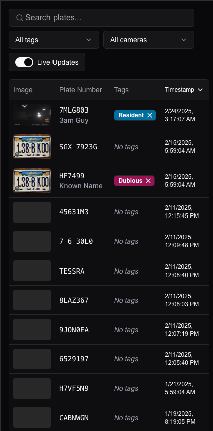

If you aren't already getting plates in the memo of your blue iris alerts, I would encourage you to please consult the ALPR threads or a youtube video and get that working first then come back here. As I said, this does not do any ALPR. Your issue is well before anything here in the pipeline.
I tried CodeProject or something similar over a year ago, but I don't remember exactly. I couldn’t make it work, so I gave up after wasting a lot of time. That was it.
Then everything you did with this database is useless.
CodeProject ALPR needs to work first. Then this database.

Yes that is the issue. These are two entirely separate systems. This is what other users were trying to explain.

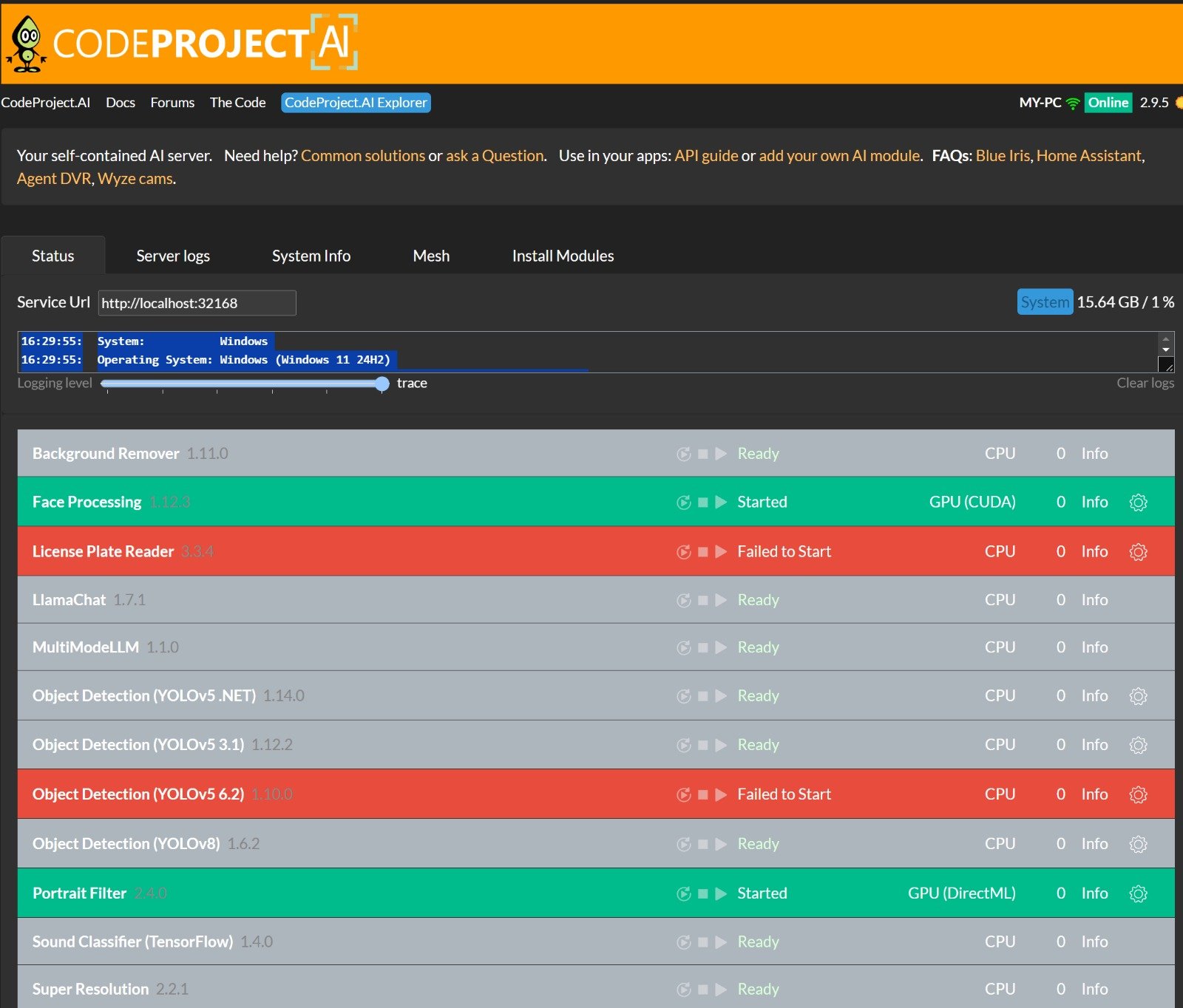

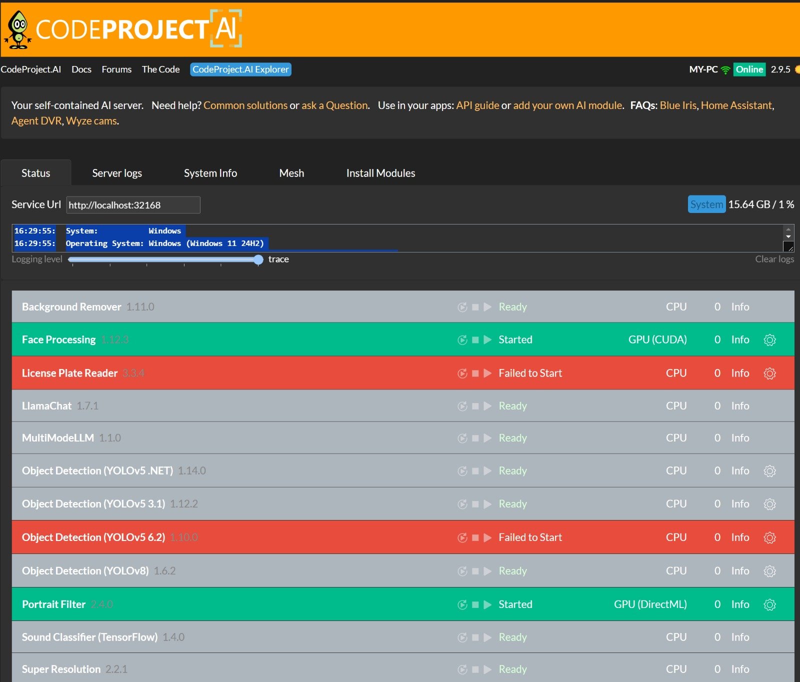

16:29:55:System: Windows
16:29:55:Operating System: Windows (Windows 11 24H2)
16:29:55:CPUs: AMD Ryzen 9 5950X 16-Core Processor (AMD)
16:29:55: 1 CPU x 16 cores. 32 logical processors (x64)
16:29:55:GPU (Primary): (NVIDIA), CUDA: 11.2 (up to: 11.2), Compute: , cuDNN:
16:29:55:System RAM: 128 GiB
16:29:55:Platform: Windows
16:29:55:BuildConfig: Release
16:29:55:Execution Env: Native
16:29:55:Runtime Env: Production
16:29:55:Runtimes installed:
16:29:55: .NET runtime: 9.0.2
16:29:55: .NET SDK: 9.0.200
16:29:55: Default Python: Not found
16:29:55: Go: Not found
16:29:55: NodeJS: Not found
16:29:55: Rust: Not found
16:29:55:App DataDir: C:\ProgramData\CodeProject\AI
16:29:55:Video adapter info:
16:29:55: NVIDIA GeForce GT 710:
16:29:55: Driver Version 27.21.14.6296
16:29:55: Video Processor GeForce GT 710
16:29:55:STARTING CODEPROJECT.AI SERVER
16:29:55:RUNTIMES_PATH = C:\Program Files\CodeProject\AI\runtimes
16:29:55:PREINSTALLED_MODULES_PATH = C:\Program Files\CodeProject\AI\preinstalled-modules
16:29:55:DEMO_MODULES_PATH = C:\Program Files\CodeProject\AI\src\demos\modules
16:29:55:EXTERNAL_MODULES_PATH = C:\Program Files\CodeProject\CodeProject.AI-Modules
16:29:55:MODULES_PATH = C:\Program Files\CodeProject\AI\modules
16:29:55:PYTHON_PATH = \bin\windows\%PYTHON_NAME%\venv\Scripts\python
16:29:55:Data Dir = C:\ProgramData\CodeProject\AI
16:29:56:Server version: 2.9.5
16:29:56:ModuleRunner Start
16:29:56:Starting Background AI Modules
16:29:59:Running module using: C:\Program Files\CodeProject\AI\runtimes\bin\windows\python37\venv\Scripts\python
16:29:59:
16:29:59:Starting C:\Program Files...ws\python37\venv\Scripts\python "C:\Program Files...ing\intelligencelayer\face.py"
16:29:59:
16:29:59:Attempting to start FaceProcessing with C:\Program Files\CodeProject\AI\runtimes\bin\windows\python37\venv\Scripts\python "C:\Program Files\CodeProject\AI\modules\FaceProcessing\intelligencelayer\face.py"
16:29:59:Module 'Face Processing' 1.12.3 (ID: FaceProcessing)
16:29:59:Valid: True
16:29:59:Module Path: <root>\modules\FaceProcessing
16:29:59:Module Location: Internal
16:29:59:AutoStart: True
16:29:59:Queue: faceprocessing_queue
16:29:59:Runtime: python3.7
16:29:59:Runtime Location: Shared
16:29:59:FilePath: intelligencelayer\face.py
16:29:59:Start pause: 3 sec
16:29:59:Parallelism: 0
16:29:59:LogVerbosity:
16:29:59:Platforms: all,!jetson
16:29:59:GPU Libraries: installed if available
16:29:59:GPU: use if supported
16:29:59:Accelerator:
16:29:59:Half Precision: enable
16:29:59:Environment Variables
16:29:59:APPDIR = <root>\modules\FaceProcessing\intelligencelayer
16:29:59:DATA_DIR = C:\ProgramData\CodeProject\AI
16:29:59:MODE = MEDIUM
16:29:59:MODELS_DIR = <root>\modules\FaceProcessing\assets
16:29:59:PROFILE = desktop_gpu
16:29:59:USE_CUDA = True
16:29:59:YOLOv5_AUTOINSTALL = false
16:29:59:YOLOv5_VERBOSE = false
16:29:59:
16:29:59:Started Face Processing module
16:30:01:Current Version is 2.9.5
16:30:01:Server: This is the latest version
16:30:02:Running module using: C:\Program Files\CodeProject\AI\modules\TextSummary\bin\windows\python37\venv\Scripts\python
16:30:02:
16:30:02:Starting C:\Program Files...ws\python37\venv\Scripts\python "C:\Program Files...extSummary\summary_adapter.py"
16:30:02:
16:30:02:Attempting to start TextSummary with C:\Program Files\CodeProject\AI\modules\TextSummary\bin\windows\python37\venv\Scripts\python "C:\Program Files\CodeProject\AI\modules\TextSummary\summary_adapter.py"
16:30:02:Module 'Text Summary' 1.9.0 (ID: TextSummary)
16:30:02:Valid: True
16:30:02:Module Path: <root>\modules\TextSummary
16:30:02:Module Location: Internal
16:30:02:AutoStart: True
16:30:02:Queue: textsummary_queue
16:30:02:Runtime: python3.7
16:30:02:Runtime Location: Local
16:30:02:FilePath: summary_adapter.py
16:30:02:Start pause: 3 sec
16:30:02:Parallelism: 1
16:30:02:LogVerbosity:
16:30:02:Platforms: all
16:30:02:GPU Libraries: not installed
16:30:02:GPU: do not use
16:30:02:Accelerator:
16:30:02:Half Precision: enable
16:30:02:Environment Variables
16:30:02:NLTK_DATA = <root>\modules\TextSummary\nltk_data
16:30:02:
16:30:02:Started Text Summary module
16:30:05:Running module using: launcher
16:30:05:
16:30:05:
16:30:05:Module 'Portrait Filter' 2.4.0 (ID: PortraitFilter)
16:30:05:Valid: True
16:30:05:Module Path: <root>\modules\PortraitFilter
16:30:05:Module Location: Internal
16:30:05:Starting C:\Program Files...rtraitFilter\PortraitFilter.exe
16:30:05:Attempting to start PortraitFilter with C:\Program Files\CodeProject\AI\modules\PortraitFilter\PortraitFilter.exe
16:30:05:AutoStart: True
16:30:05:Queue: portraitfilter_queue
16:30:05:Runtime: dotnet
16:30:05:Runtime Location: System
16:30:05:FilePath: PortraitFilter.exe
16:30:05:Start pause: 1 sec
16:30:05:Parallelism: 1
16:30:05:LogVerbosity:
16:30:05:Platforms: windows
16:30:05:GPU Libraries: installed if available
16:30:05:GPU: use if supported
16:30:05:Accelerator:
16:30:05:Half Precision: enable
16:30:05:Environment Variables
16:30:05:
16:30:05:Started Portrait Filter module
16:30:06:PortraitFilter.exe: Application started. Press Ctrl+C to shut down.
16:30:06:PortraitFilter.exe: Hosting environment: Production
16:30:06:PortraitFilter.exe: Content root path: C:\Program Files\CodeProject\AI\modules\PortraitFilter
16:30:06:Running module using: C:\Program Files\CodeProject\AI\modules\ALPR\bin\windows\python39\venv\Scripts\python
16:30:06:Starting C:\Program Files...ws\python39\venv\Scripts\python "C:\Program Files...\modules\ALPR\ALPR_adapter.py"
16:30:06:
16:30:06:Attempting to start ALPR with C:\Program Files\CodeProject\AI\modules\ALPR\bin\windows\python39\venv\Scripts\python "C:\Program Files\CodeProject\AI\modules\ALPR\ALPR_adapter.py"
16:30:06:
16:30:06:Module 'License Plate Reader' 3.3.4 (ID: ALPR)
16:30:06:Valid: True
16:30:06:Module Path: <root>\modules\ALPR
16:30:06:Module Location: Internal
16:30:06:AutoStart: True
16:30:06:Queue: alpr_queue
16:30:06:Runtime: python3.9
16:30:06:Runtime Location: Local
16:30:06:FilePath: ALPR_adapter.py
16:30:06:Start pause: 3 sec
16:30:06:Parallelism: 0
16:30:06:LogVerbosity:
16:30:06:Platforms: all,!windows-arm64
16:30:06:GPU Libraries: installed if available
16:30:06:GPU: use if supported
16:30:06:Accelerator:
16:30:06:Half Precision: enable
16:30:06:Environment Variables
16:30:06:AUTO_PLATE_ROTATE = True
16:30:06:CROPPED_PLATE_DIR = <root>\Server\wwwroot
16:30:06:MIN_COMPUTE_CAPABILITY = 6
16:30:06:MIN_CUDNN_VERSION = 7
16:30:06:OCR_OPTIMAL_CHARACTER_HEIGHT = 60
16:30:06:OCR_OPTIMAL_CHARACTER_WIDTH = 30
16:30:06:OCR_OPTIMIZATION = true
16:30:06:PLATE_CONFIDENCE = 0.80
16:30:06:PLATE_RESCALE_FACTOR = 2
16:30:06:PLATE_ROTATE_DEG = 0
16:30:06:REMOVE_SPACES = False
16:30:06:ROOT_PATH = <root>
16:30:06:SAVE_CROPPED_PLATE = False
16:30:06:
16:30:06:Started License Plate Reader module
16:30:08:Portrait Filter: Portrait Filter module started.

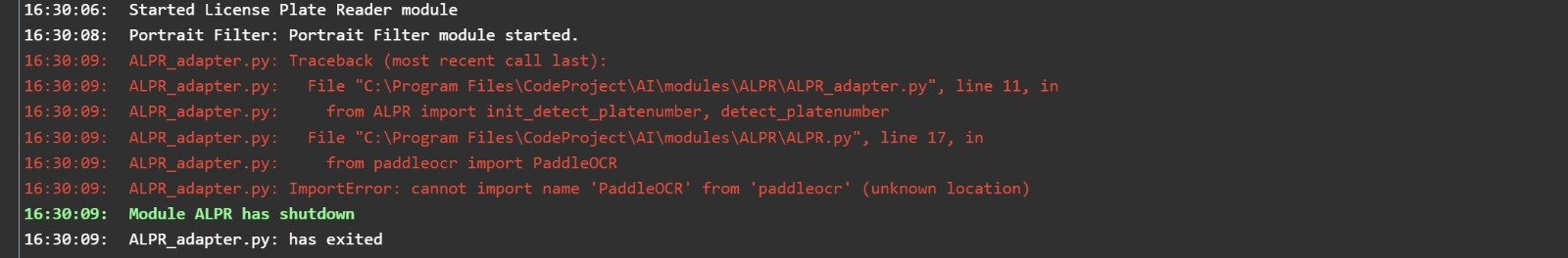

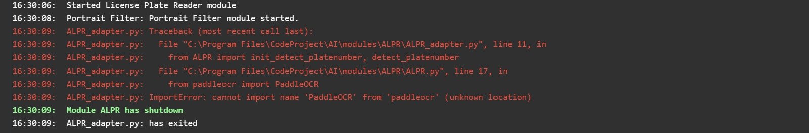

16:30:09:ALPR_adapter.py: Traceback (most recent call last):
16:30:09:ALPR_adapter.py: File "C:\Program Files\CodeProject\AI\modules\ALPR\ALPR_adapter.py", line 11, in
16:30:09:ALPR_adapter.py: from ALPR import init_detect_platenumber, detect_platenumber
16:30:09:ALPR_adapter.py: File "C:\Program Files\CodeProject\AI\modules\ALPR\ALPR.py", line 17, in
16:30:09:ALPR_adapter.py: from paddleocr import PaddleOCR
16:30:09:ALPR_adapter.py: ImportError: cannot import name 'PaddleOCR' from 'paddleocr' (unknown location)
16:30:09:Module ALPR has shutdown
16:30:09:ALPR_adapter.py: has exited
16:30:09:Running module using: C:\Program Files\CodeProject\AI\runtimes\bin\windows\python37\venv\Scripts\python
16:30:09:Starting C:\Program Files...ws\python37\venv\Scripts\python "C:\Program Files...nYOLOv5-6.2\detect_adapter.py"
16:30:09:
16:30:09:Attempting to start ObjectDetectionYOLOv5-6.2 with C:\Program Files\CodeProject\AI\runtimes\bin\windows\python37\venv\Scripts\python "C:\Program Files\CodeProject\AI\modules\ObjectDetectionYOLOv5-6.2\detect_adapter.py"
16:30:09:
16:30:09:Module 'Object Detection (YOLOv5 6.2)' 1.10.0 (ID: ObjectDetectionYOLOv5-6.2)
16:30:09:Valid: True
16:30:09:Module Path: <root>\modules\ObjectDetectionYOLOv5-6.2
16:30:09:Module Location: Internal
16:30:09:AutoStart: True
16:30:09:Queue: objectdetection_queue
16:30:09:Runtime: python3.7
16:30:09:Runtime Location: Shared
16:30:09:FilePath: detect_adapter.py
16:30:09:Start pause: 1 sec
16:30:09:Parallelism: 0
16:30:09:LogVerbosity:
16:30:09:Platforms: all,!raspberrypi,!jetson
16:30:09:GPU Libraries: installed if available
16:30:09:GPU: use if supported
16:30:09:Accelerator:
16:30:09:Half Precision: enable
16:30:09:Environment Variables
16:30:09:APPDIR = <root>\modules\ObjectDetectionYOLOv5-6.2
16:30:09:CUSTOM_MODELS_DIR = <root>\modules\ObjectDetectionYOLOv5-6.2\custom-models
16:30:09:MODELS_DIR = <root>\modules\ObjectDetectionYOLOv5-6.2\assets
16:30:09:MODEL_SIZE = Medium
16:30:09:USE_CUDA = True
16:30:09:YOLOv5_AUTOINSTALL = false
16:30:09:YOLOv5_VERBOSE = false
16:30:09:
16:30:09:Started Object Detection (YOLOv5 6.2) module

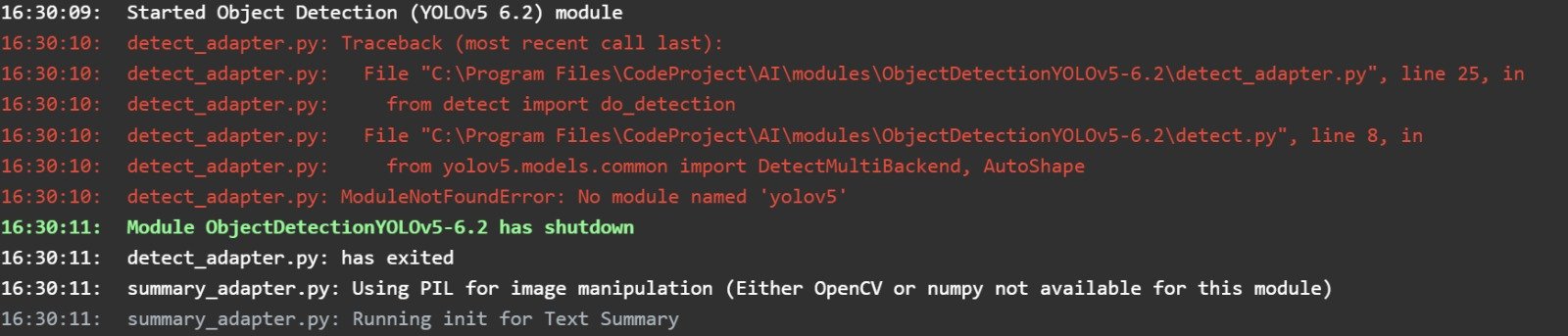

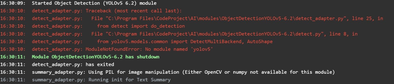

16:30:10:detect_adapter.py: Traceback (most recent call last):
16:30:10:detect_adapter.py: File "C:\Program Files\CodeProject\AI\modules\ObjectDetectionYOLOv5-6.2\detect_adapter.py", line 25, in
16:30:10:detect_adapter.py: from detect import do_detection
16:30:10:detect_adapter.py: File "C:\Program Files\CodeProject\AI\modules\ObjectDetectionYOLOv5-6.2\detect.py", line 8, in
16:30:10:detect_adapter.py: from yolov5.models.common import DetectMultiBackend, AutoShape
16:30:10:detect_adapter.py: ModuleNotFoundError: No module named 'yolov5'
16:30:11:Module ObjectDetectionYOLOv5-6.2 has shutdown
16:30:11:detect_adapter.py: has exited
16:30:11:summary_adapter.py: Using PIL for image manipulation (Either OpenCV or numpy not available for this module)
16:30:11:summary_adapter.py: Running init for Text Summary
Mobile will look something like this. Tap and hold on the record to bring up action options. Coming soon...
"3 AM Guy" Seems to work a 7 day night shift and comes home 7 days a week between 2 and 4 in the morning. Like clockwork. Never misses. Usually the only vehicle during that period every night.
