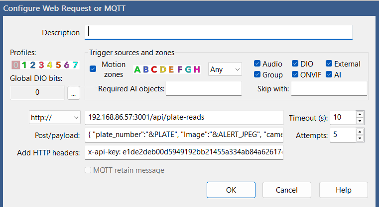

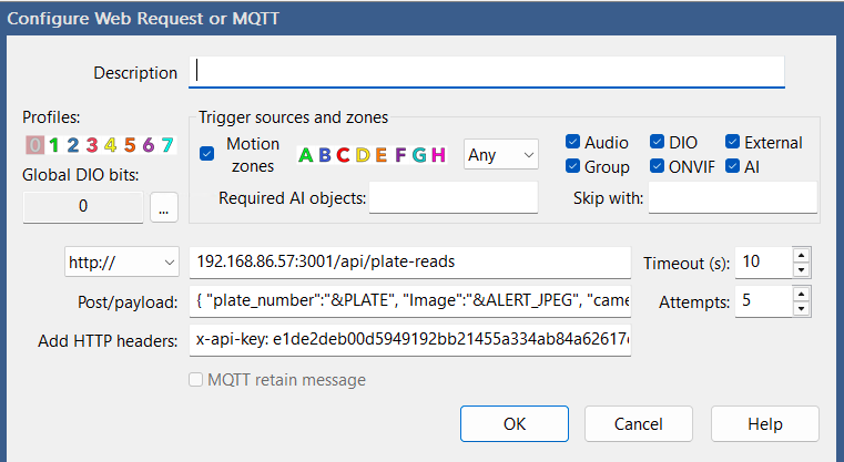

You fixed the missing x-api-key issue, but did you fix the missing "/api/plate-reads" in your ip address? It should be MY-PC:3000/api/plate-readsfixed the missing x-api-key:
Good spot. @Vettester is right. I would use localhost instead of your hostname too if it’s the same machine just to prevent any issues.You fixed the missing x-api-key issue, but did you fix the missing "/api/plate-reads" in your ip address?
Post a screenshot of your configuration.i get this error
I asked him that and he said he was but it looks like he deleted that post.Were you actually capturing plates in BI before jumping down this rabbit hole or did you think this was the magic solution?
i misunderstood your post, i edited the reply later.I asked him that and he said he was but it looks like he deleted that post.
what configuration you are referring to? i'm trying this for more info please check my previous post Full ALPR Database System for Blue Iris!Post a screenshot of your configuration.
I saw your previous post. I just want to confirm you had everything configured correctly after you changed it.what configuration you are referring to? i'm trying this for more info please check my previous post Full ALPR Database System for Blue Iris!
Oh! Okay, I just fixed that part. Thanks for spotting that error!
And your accessing the app using MY-PC:3000 in a browser?
Sorry, that was my mistake I was adding it to the browser instead of the settings.

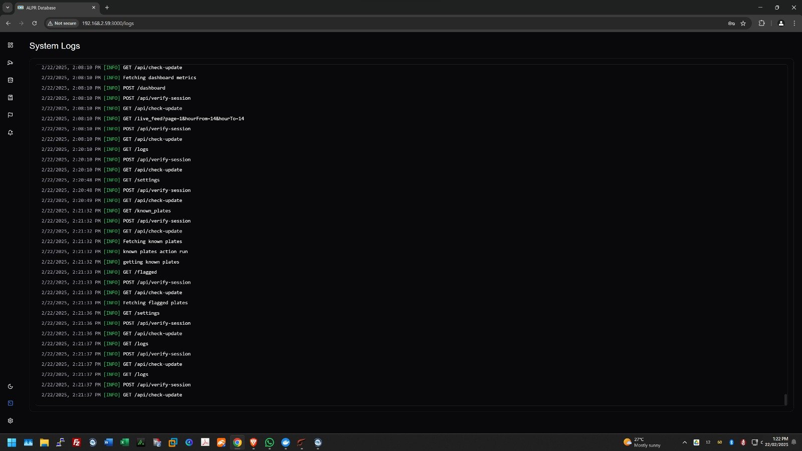

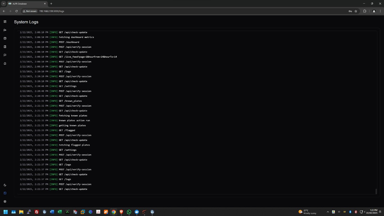

Did you use the install script or did you create the directories and copy the files manually? Please check the logs tab at the bottom left of the app also and see if there are any other errors there. @sunny0101786
logsWhere did /dashboard/ come from? It should look exactly as it does in the example.

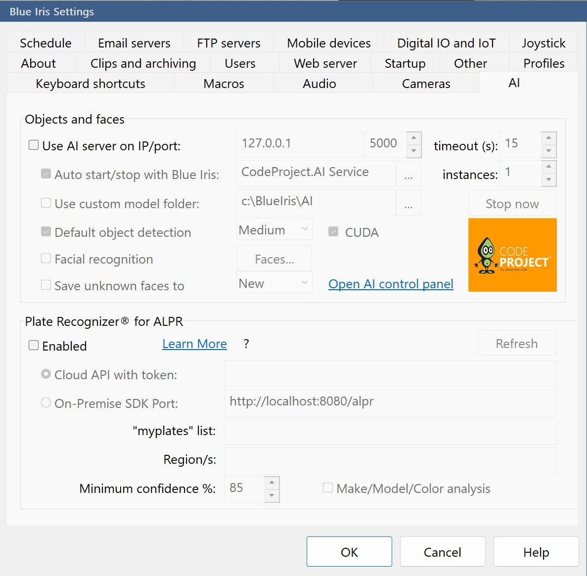

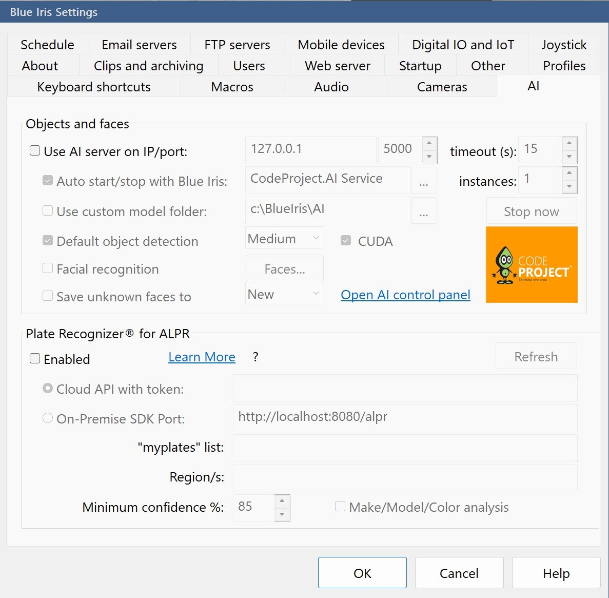

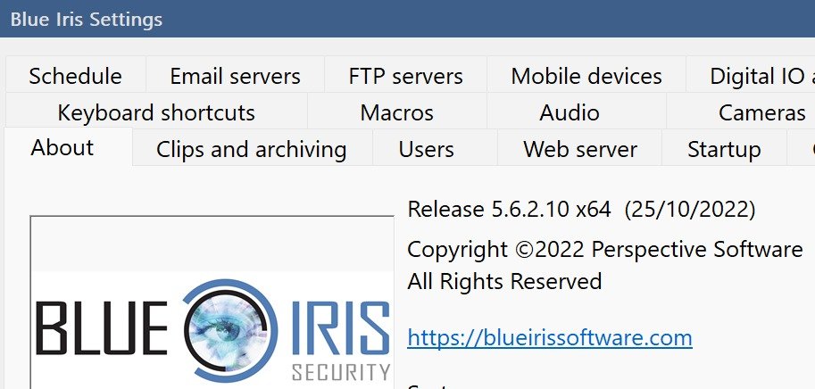

It looks like your AI is disabled? Unless you have the server override set in the camera you should have the top box ticked.Do I need to change any settings in the AI menu?
