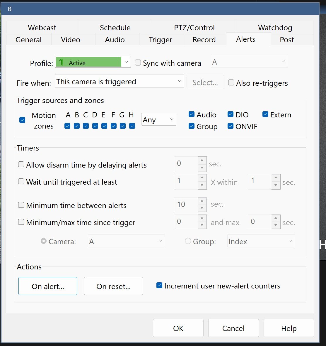

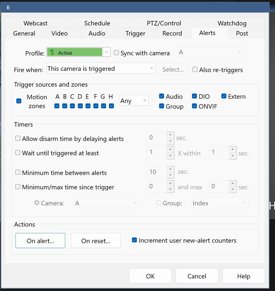

i don't see that option please see attached screenshot@sunny0101786 In blue Iris, go to the camera you use for ALPR, go to alert tab, under alert, go to alert actions, then click + and select MQTT/Web request

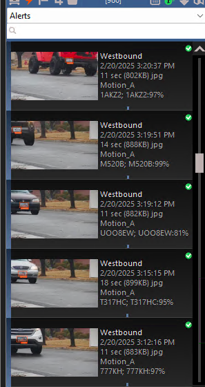

Done! now i'm waiting for the vehicles to pass on my street ha! ha!
thanks guys! let you know once i find more progress.

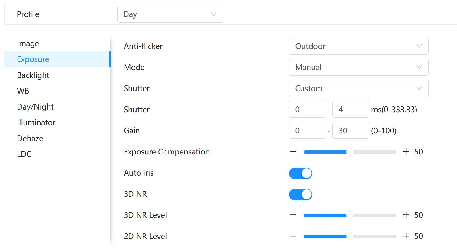

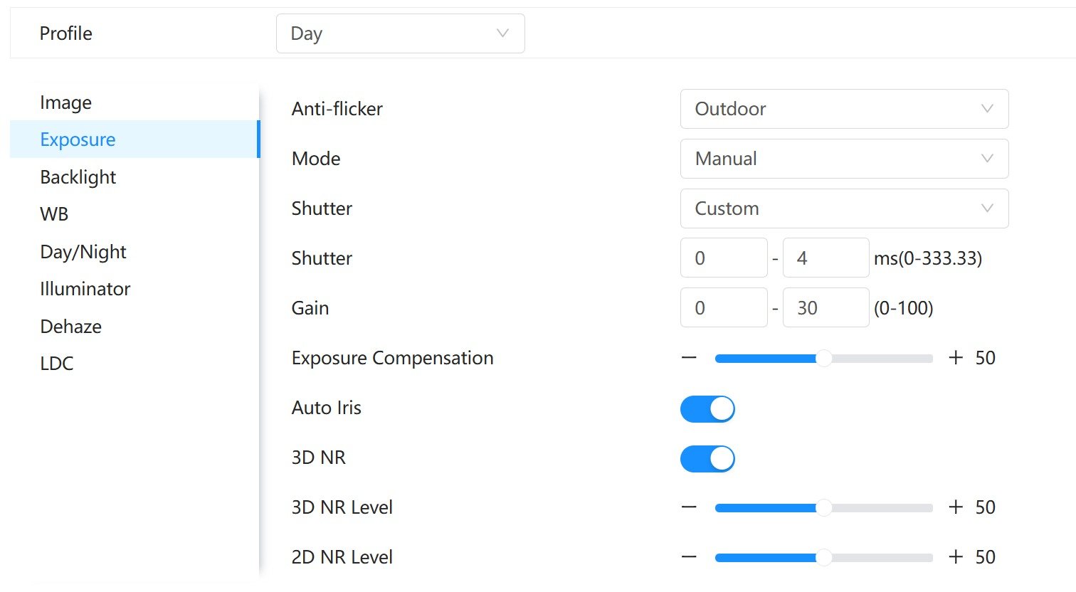

You are going to need more zoom, especially at night, and dial it on for plates with a fast shutter and at night all you will see are the plates and head/tail lights.
what is the best fast shutter speed setting?
At night 1/2000 shutter and gain no higher than 50. Image will be completely black.

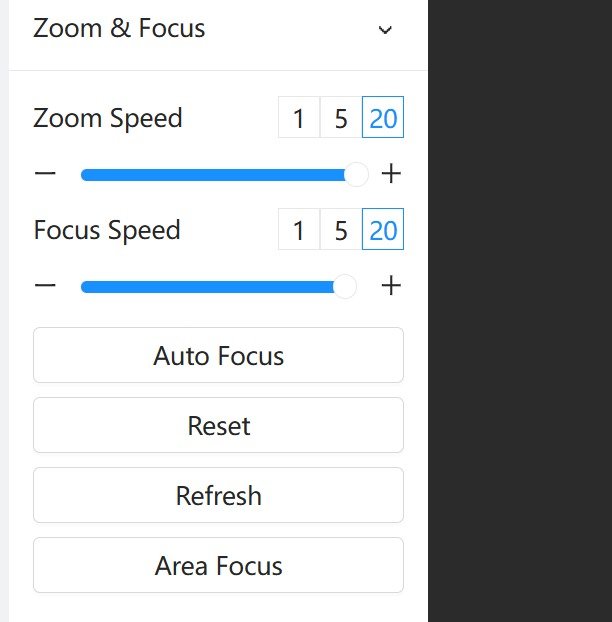

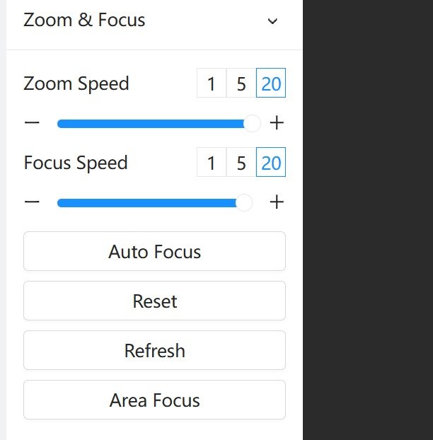

camera is fully zoomed in and fixed the missing x-api-key: :)

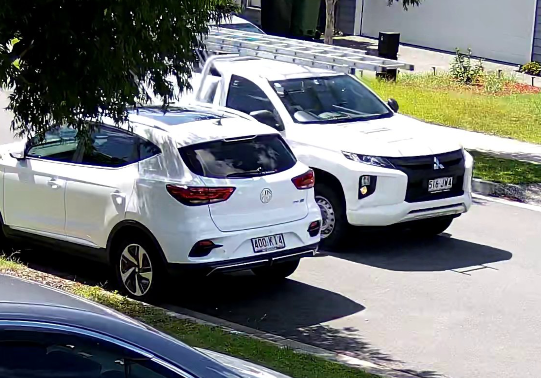

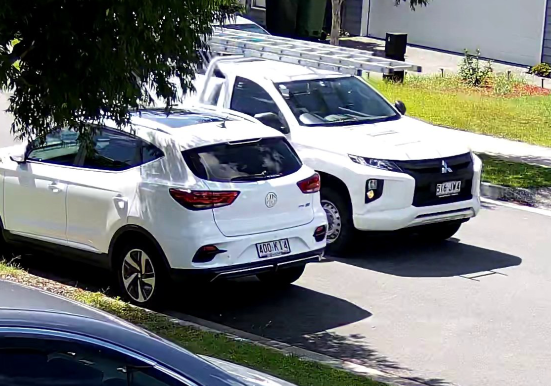

Yeah, you need a lot more zoom. Try zooming in so that the frame is like this:
You should also get your day time reads working pretty well before even trying to make night time reads work.
