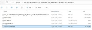

@Tinman: That looks like the Dahua firmware (logo and Product Documentation) per my earlier post. - I assume you downloaded it and it's the 0827 version.
Did you notice that there was a "web-x-squashfs.bin" file in the download?
I haven't seen that before and did NOT apply (usually it's just the two "IPC" and firmware .bin files ... that I apply in that order) - does anyone (@steve1225 ?) know what it is?

yes there was. When I did the upgrade I selected folder and it did the whole firmware the same time, only rebooted once.
