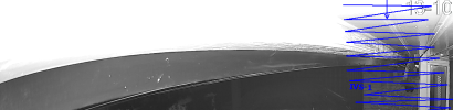

Hard to say what we’re looking at. Show the full uncropped image
Reactions: duplo
Horrible IR reflection
Gotta reposition that camera. Try first to aim/focus is so there is no ceiling in the view, point it down more.
How can I fix that ? 54pro Ze
Zoomed in 2000.
Shutter : 7 , Gain : 50 , NR : 40
Ok so that second pic is better. I’d look at adding an IR Illuminator that can help light that far corner
Reactions: duplo
I agree but I'd also consider lowering it's position. It looks a bit high (around 8-9 feet?) and mounting it lower will reduce the ceiling reflection as well as giving a better facial shot.
