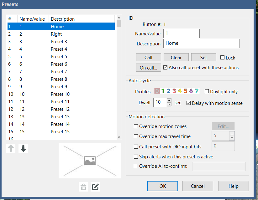

How do I have the ptz ignore the spotter cam's new 'do command' request/alert and not have the ptz move away?
When the ptz is already recording/tracking/triggered

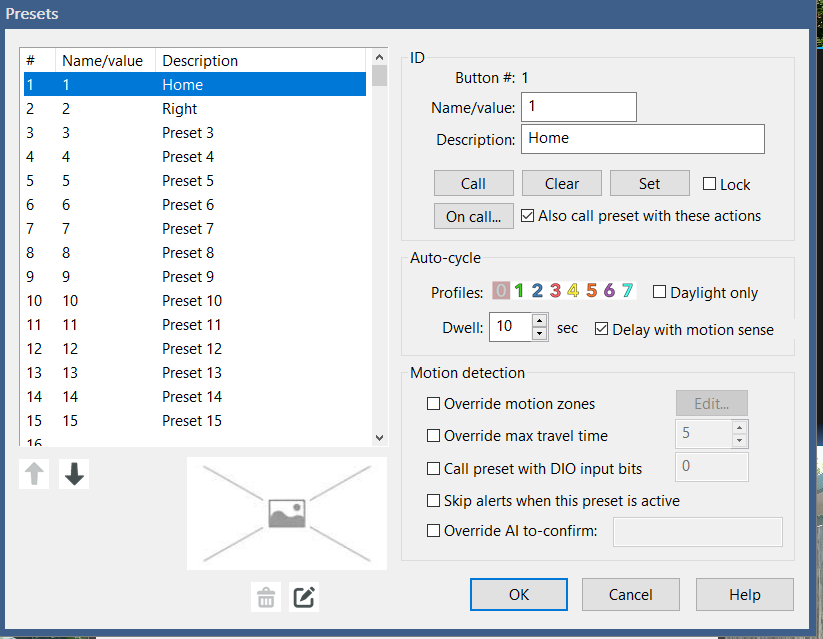

You can go into the PTZ tab in the Camera setttings and go to the preset that you want to have priority and check the "cancel alerts when the camera is focused on specific PTZ presets" box and then if it is tracking on that preset then another spotter cam will not override it.
