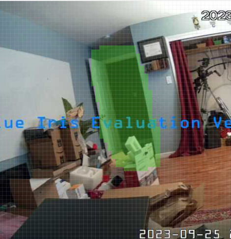

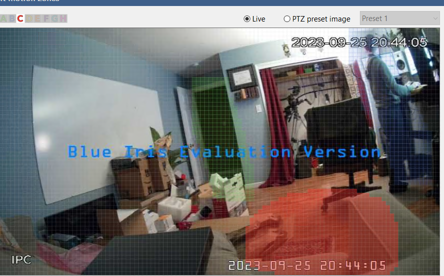

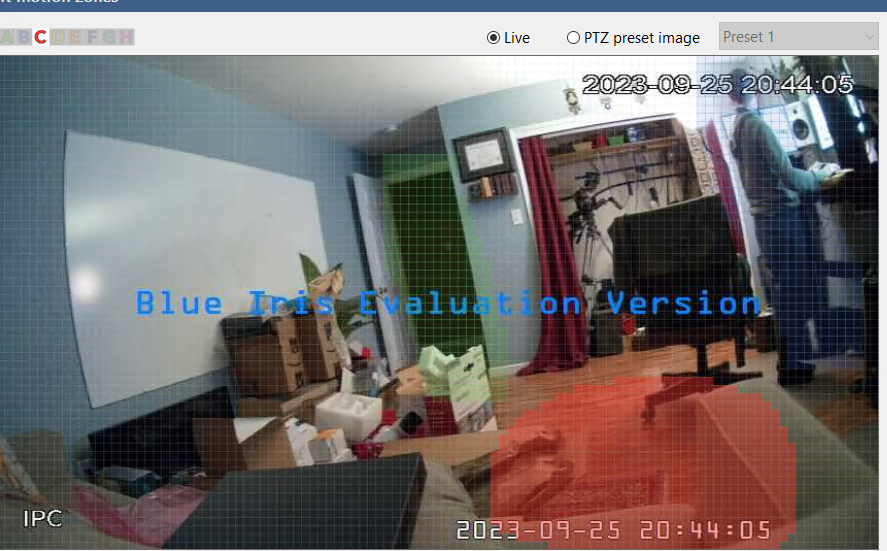

How do you set multiple area of detection within one spotter camera?
I only know this:
And when I try that, the preset to zone binding doesn't stick (here, I set ptz preset image to preset 3 on zone C)
I have found it is more effective and faster to create clone cameras if you are going to use one camera as a spotter.
Maybe it works better within one camera and zones in a newer BI version, but I had the most success with clones if using the same camera.

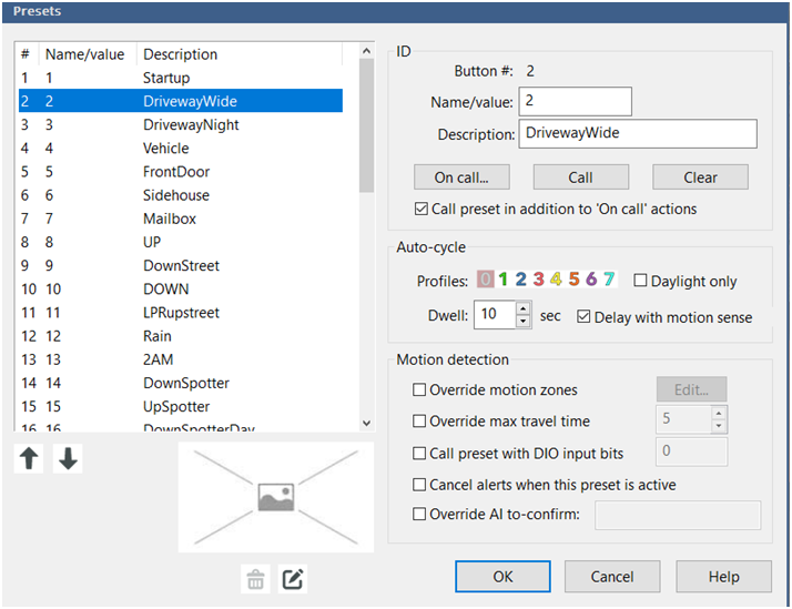

You need to set the preset within the PTZ GUI for the areas you want the spotter to move to.
Then you need to confirm that BI can move the PTZ to the presets.
When you go to this screen can you call up the PTZ presets (does the PTZ move as you call up a preset?)

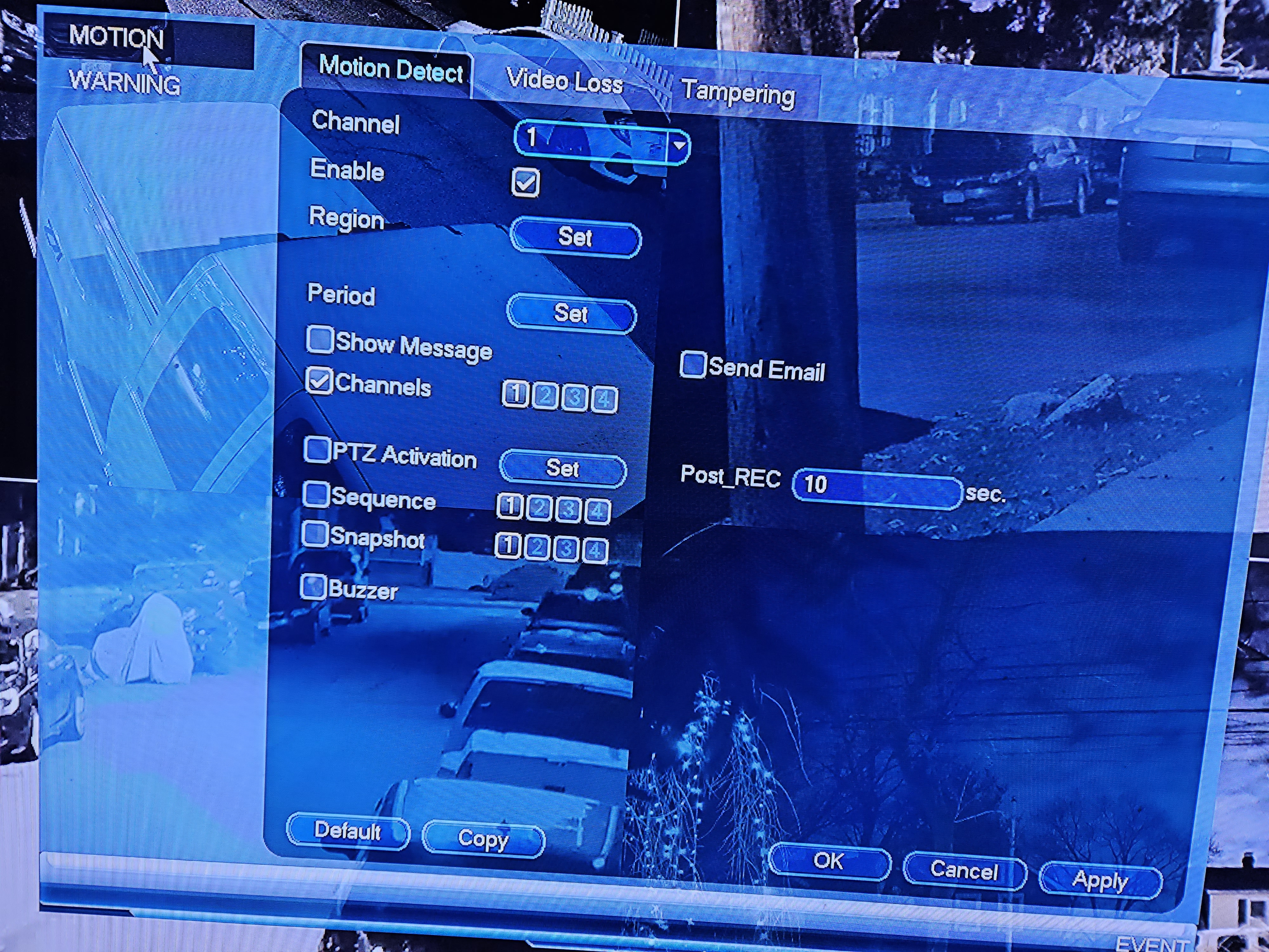

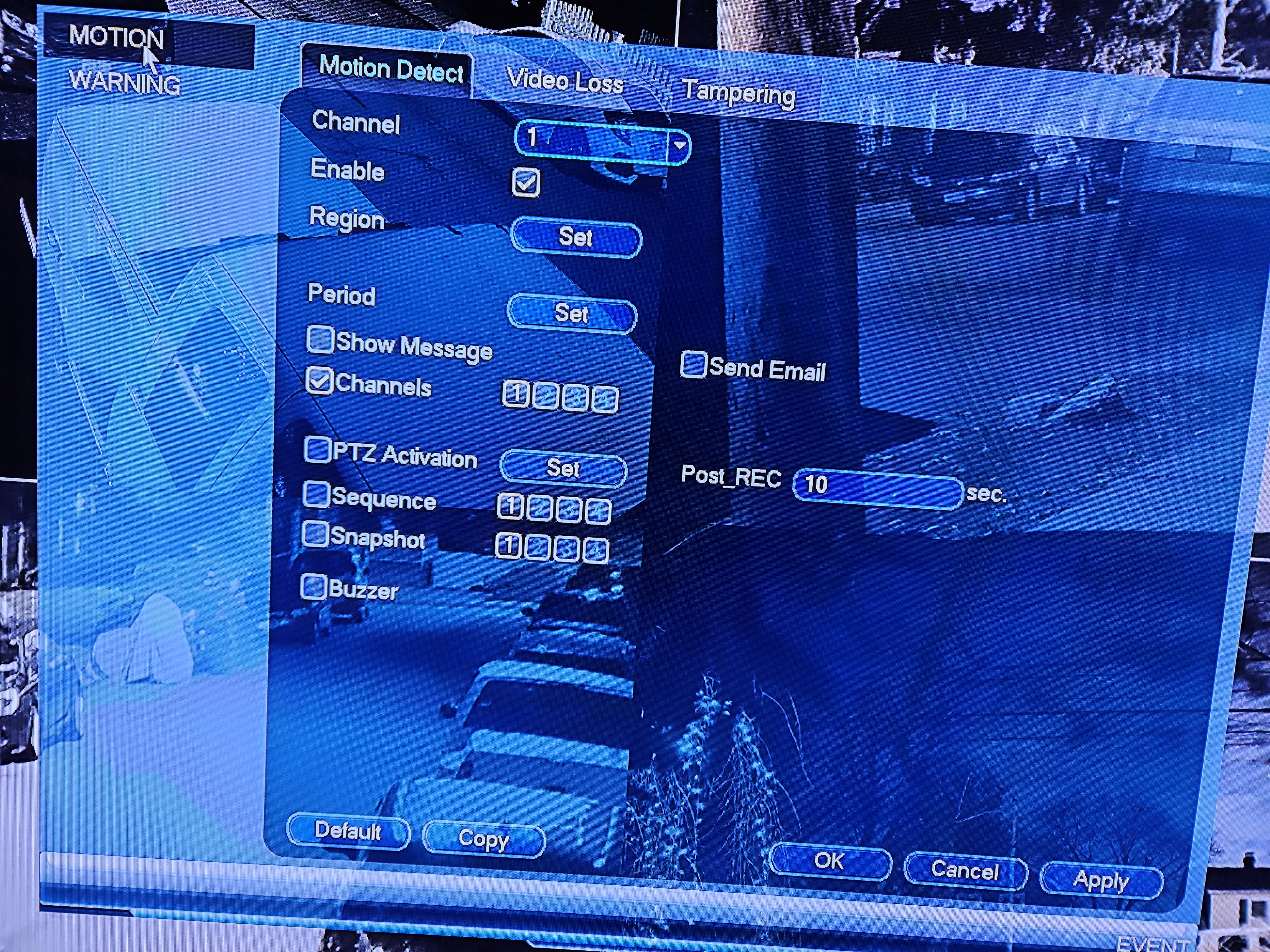

I tried looking myself for where this option to allow me to use a spotter cam might be and not sure where it is...the only thing I found that might be helpful is this picture. Please let me know if this is what you guys are talking about. Also I called Lorex and asked them if their system could do this and they said no. I spoke with a supervisor in their tech dept. I first asked if mine could and if they had any NVR that could and he said no but said it was great idea and will pass along so they could maybe include it. I know it is possible cause wittaj said his neighbor can but might have different ver NVR.
So if someone can please take a sec and look at pic and or check out the NVR ver I have and confirm if it can do this. As mentioned I tried calling tech support for the help but it was waste of time. Thanks in advance
Looks like your NVR doesn't have IVS rules?

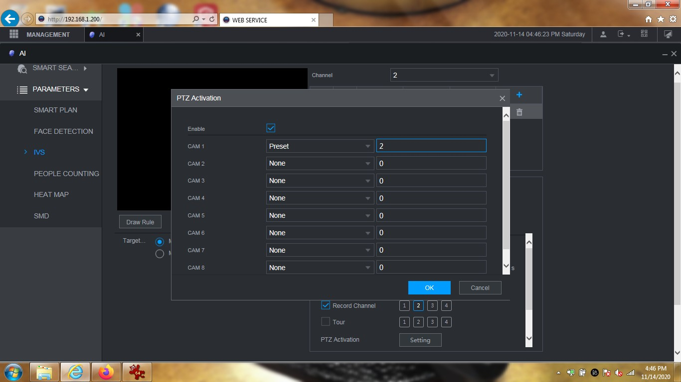

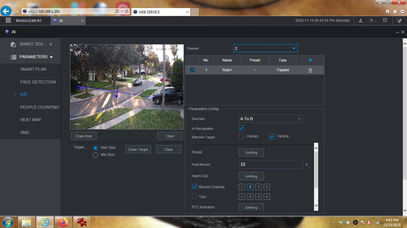

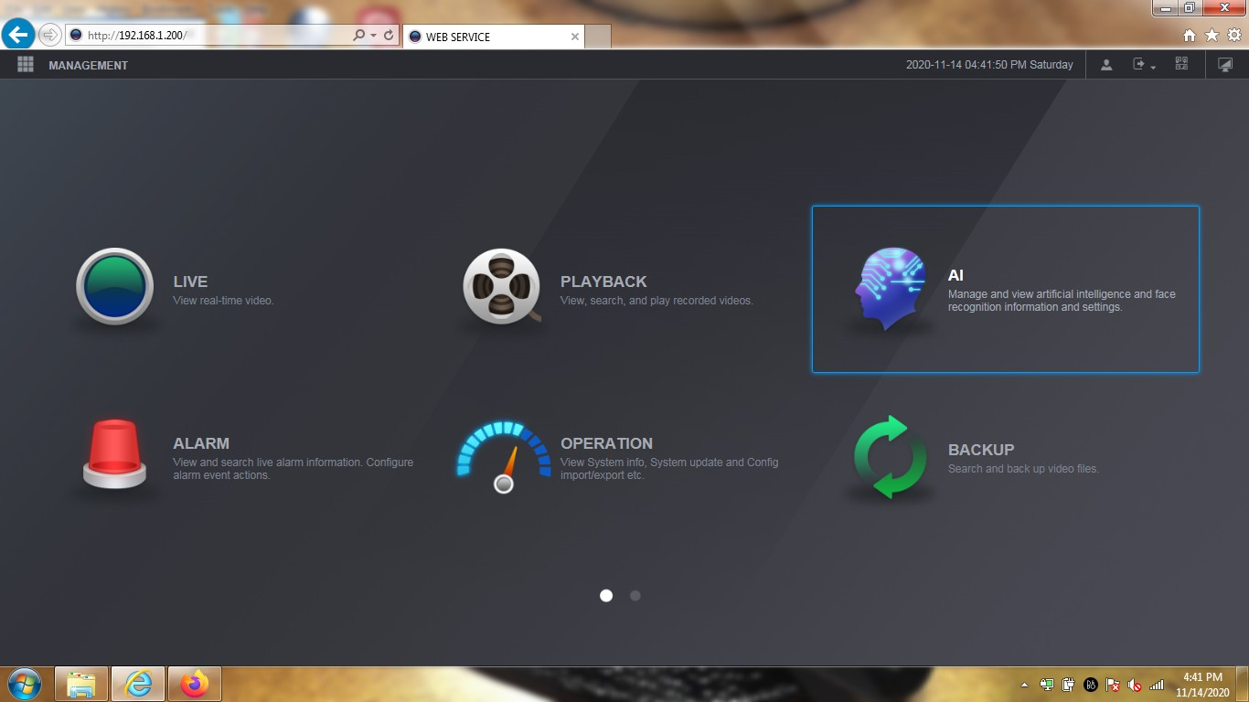

From the link in the first post for a Dahua OEM NVR:
Preset #1 is the “home” preset
Preset # 2 is the scene you want the PTZ to move to when commanded by the spotter
-On the NVR go to AI
-Then choose "Parameters" and IVS and go to the spotter camera IVS rule
-Go down to "PTZ Activation" and in the popup choose the PTZ on the left list (cam 1 for me) and enter the number on the right of the PTZ Preset you want it to go to when the IVS rule on the spotter cam is tripped (Preset 2)
