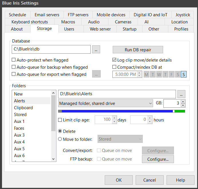

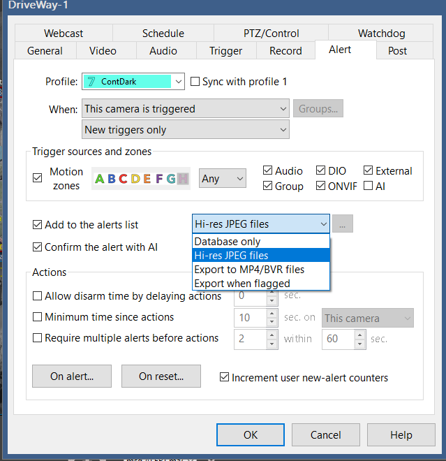

I am saving jpgs in a Jpgs folder. Should I use that instead of the Alerts folder?
Drive is the cam name. I'll read the other links
if you mean this setting, these JPGs are stored in the Alerts folder.
You should use the path is assigned the Alerts folder in the Settings > Storage folder...
OK, thats I;/Alerts

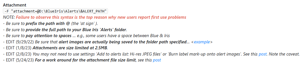

I was having issues with alerts being sent after changing the path to where the alerts are being saved. While typing this up I now see that I should have looked at this first... however...
If alerts should be workings, but aren't through PushOver, I was able to test via cmd.exe and then deleting arguments until I got a response back there. Essentially, my path to the image was incorrect as a SPACE was in the original path, but not the new path... Deleting the path from the cmd.exe test showed it very quickly. Hope this helps someone else.

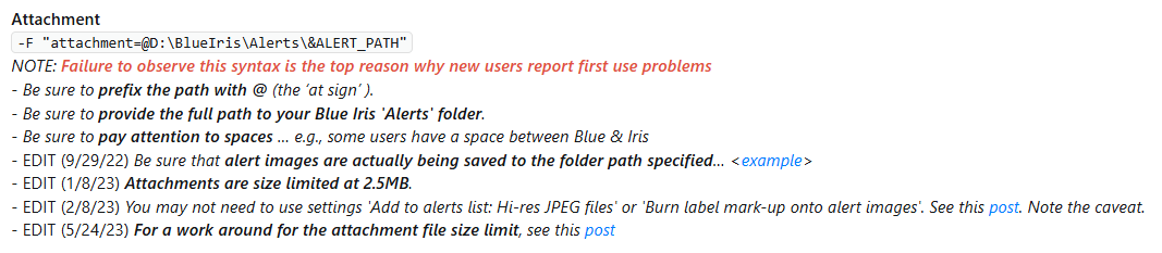

I realize the original post is dense, so all reminders help. :p
Excerpt from the API Syntax Reference Guide in post #1.
