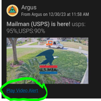

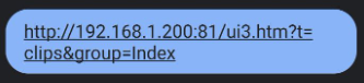

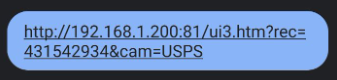

Sometimes when I receive a push notification the link (Play Video Alert) generated does not work. Taking a closer look I can see that the curl script sometimes generates a link with is not valid. When you click on the Play Video Alert link, instead of the video clip playing in UI3, I get an error message that it can't open the link. For some reason the formed string creates a link that is not valid.
When it works correctly the link generated looks like this:
But sometimes it generates a link like this which doesn't work:
Here's my json command:

I can replicate the funky URL in a browser by using the following
ui3.htm?rec=&cam=mycam
So I would agree that the likely cause is that macro &ALERT_DB is not resolving.
Recommend that you email Ken and inquire if it’s possible that a race condition is resulting in the unresolved (blank) macro. Perhaps he can code a fix.
