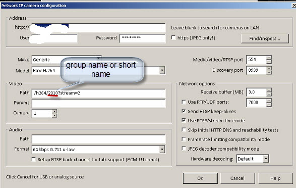

And if that doesn't work (or in my case, is too complicated to even try), you can always add the desired cameras from one BI server to another. I have three BI servers that I monitor. To each, I add a camera that shows the index view of the other servers' cameras.
Simply add a new camera, and use the settings in the attachment below. You can use a specific camera's short name, or you can specify a group name. Note that a "group" must have at least two cameras in it.
Add "?stream=X" to specify the specific stream (bit rate) you want to pull from the other server.
