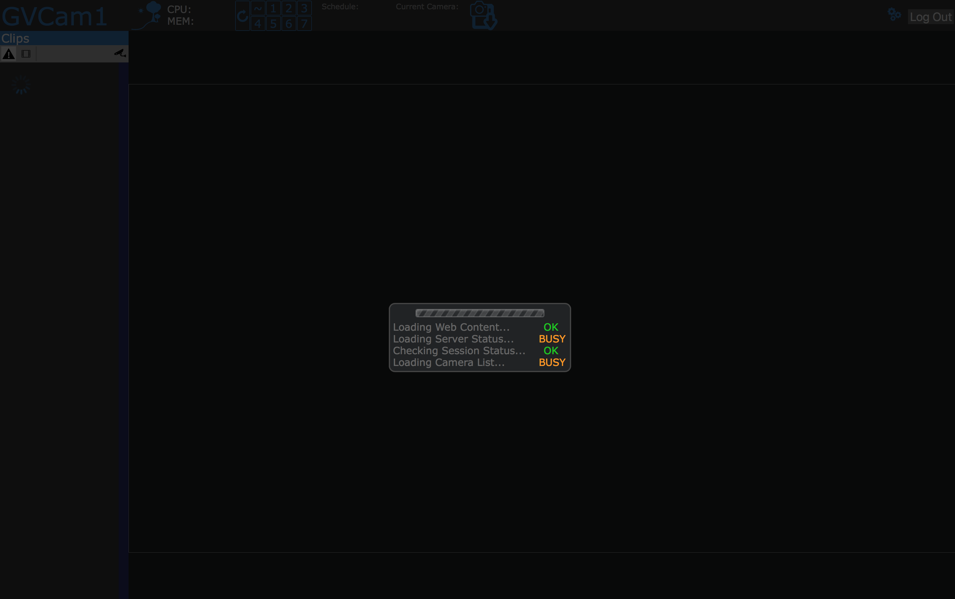

Now I am actually getting the page partially loading, and hangs as per the attached image.
Try CTRL + F5. If that works then great, otherwise you probably have a Javascript error which is usually caused by one of 3 things:
1) Your browser could be very out of date.
2) The files did not all extract correctly or they are out of date. Re-download them from the first post in this thread and carefully extract again. Overwrite all files when you put them into Blue Iris 4/www/
3) Your Blue Iris configuration could be strange in a way I did not anticipate, causing the script to be broken.
In this case you can't resolve the problem yourself, you must open your browser's developer tools (CTRL + I or F12 depending on which browser) and open the console tab, then refresh the page and copy any errors you find to a reply here. Some error messages are to be expected in there, since ui2 attempts to load a few files which do not normally exist (ui2-local-overrides.js and ui2-local-overrides.css). You can ignore those. But if you have a script error, that would explain the problem and hopefully allow me to fix it.

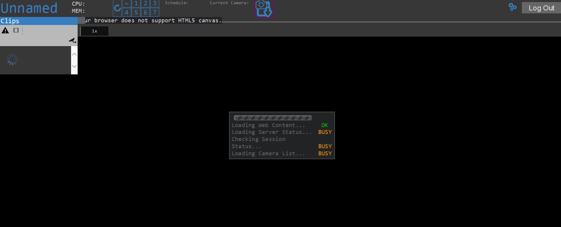

I stand corrected. Maybe mine wasn't the latest version when testing, but as of today, the website no longer connects to the server either!

I'm on 4.3.0.4 x64 version. Is that what you are running? Any idea why the generic BI pages work, but the awesome ones won't connect now?
Mine is working too - BI:4.3.0.4 and UI2:0.10.0
OH... it's a safari thing. I'm giving a presentation today to sell blue iris to my administrators in our school district to save a lot of money from our aging ONSSI system. It works in Chrome on my mac thankfully... :)
Yes, same version. Check your Web server options and see if maybe the root directory got changed.

Mine is version 9.0.3... perhaps that's the problem... can you update and try with version 9?
When I connect, instead of the green box in the lower right, I get a red box that says it cannot connect to the blue iris server... if that helps? :)
Man you have to be more specific when troubleshooting computers :)
If you are getting that (is the exact message "Unable to contact Blue Iris server." ???), then you've definitely connected and loaded the ui2 page (contrary to what you were suggesting) but something is going wrong when it tries to use the Blue Iris JSON API. Specifically that message happens when there was a failure with the login function that upgrades your Blue Iris session to administrator. I will see about getting the mac updated but it is not really a priority for me...
