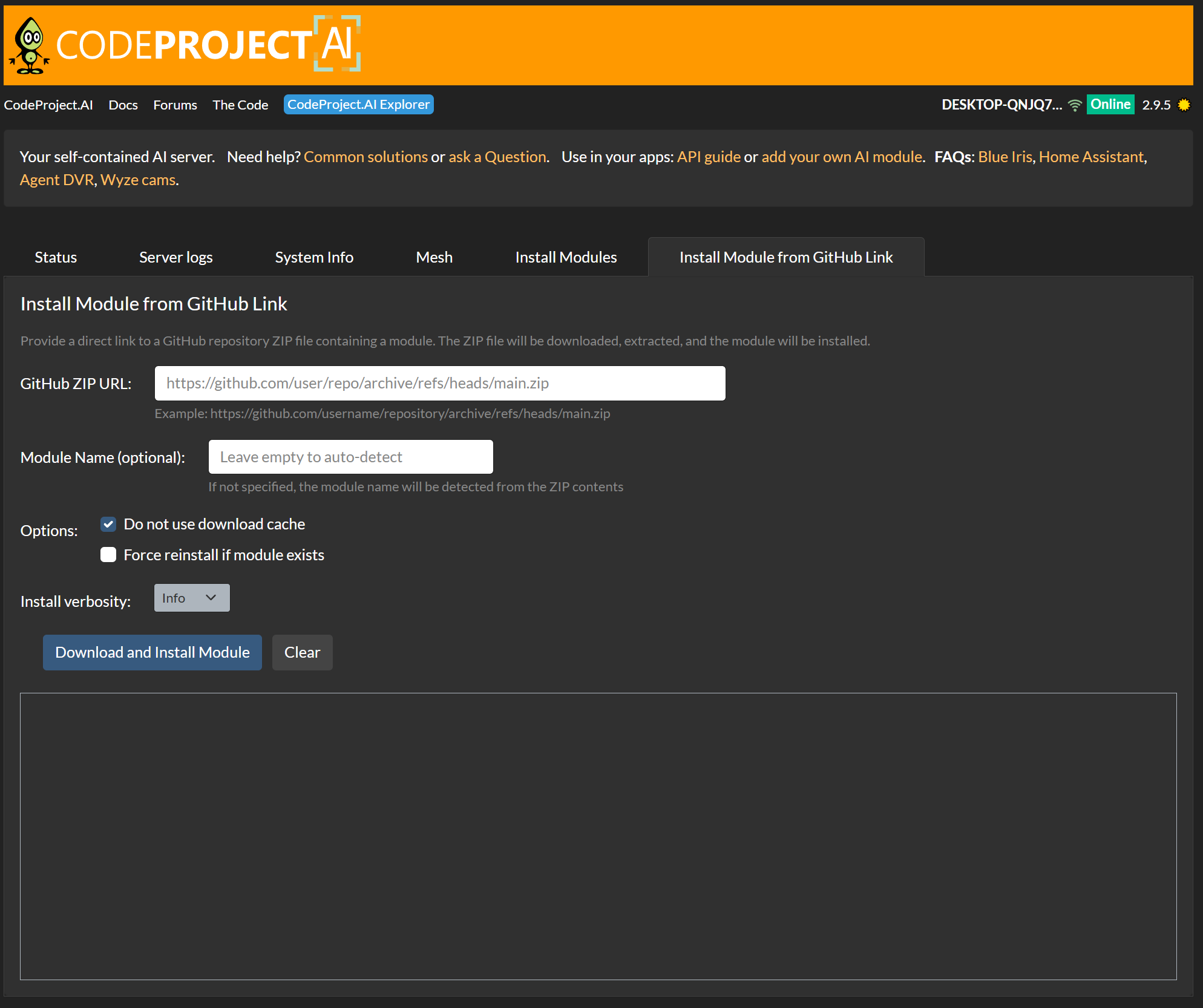

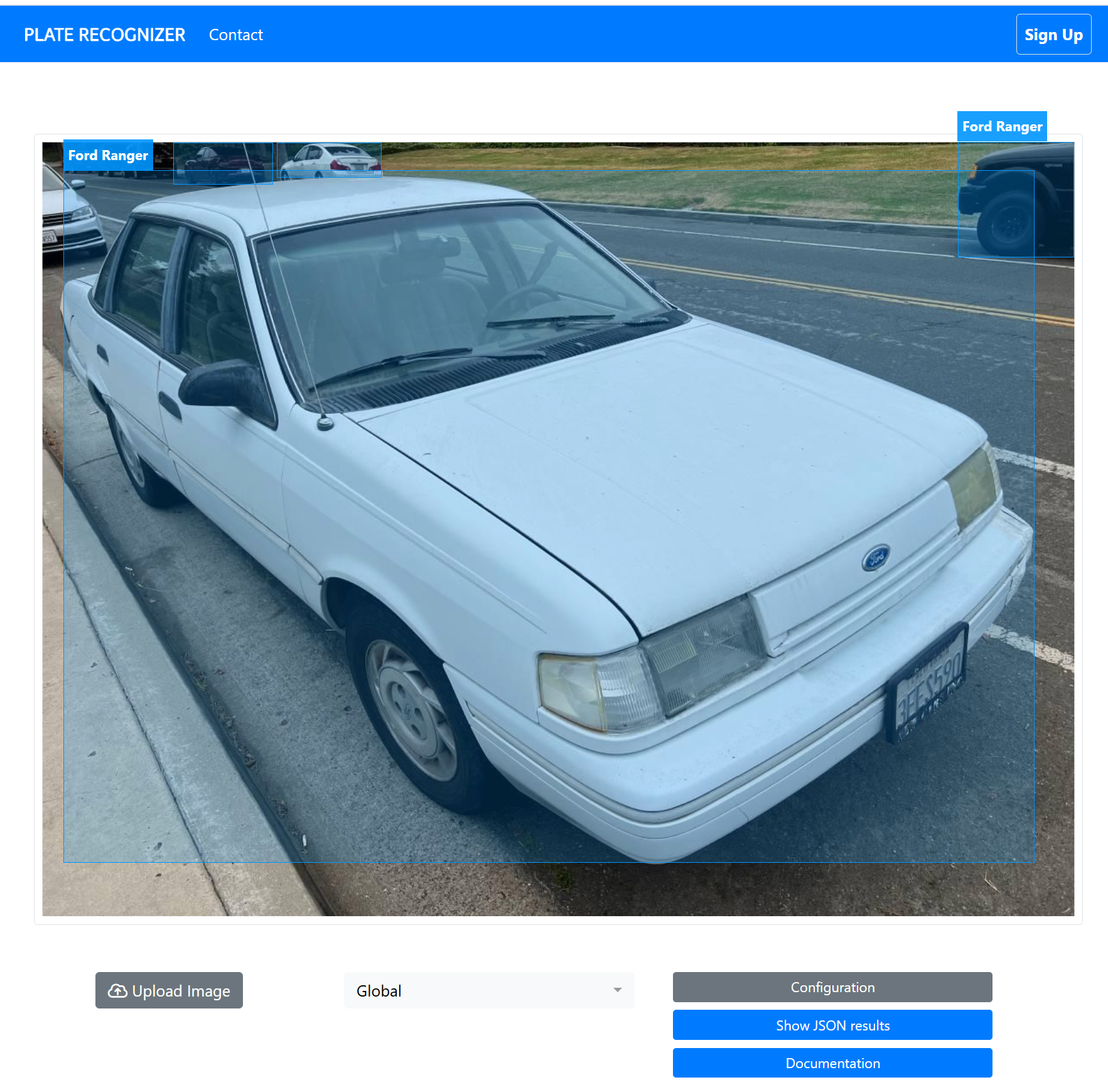

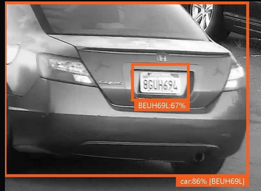

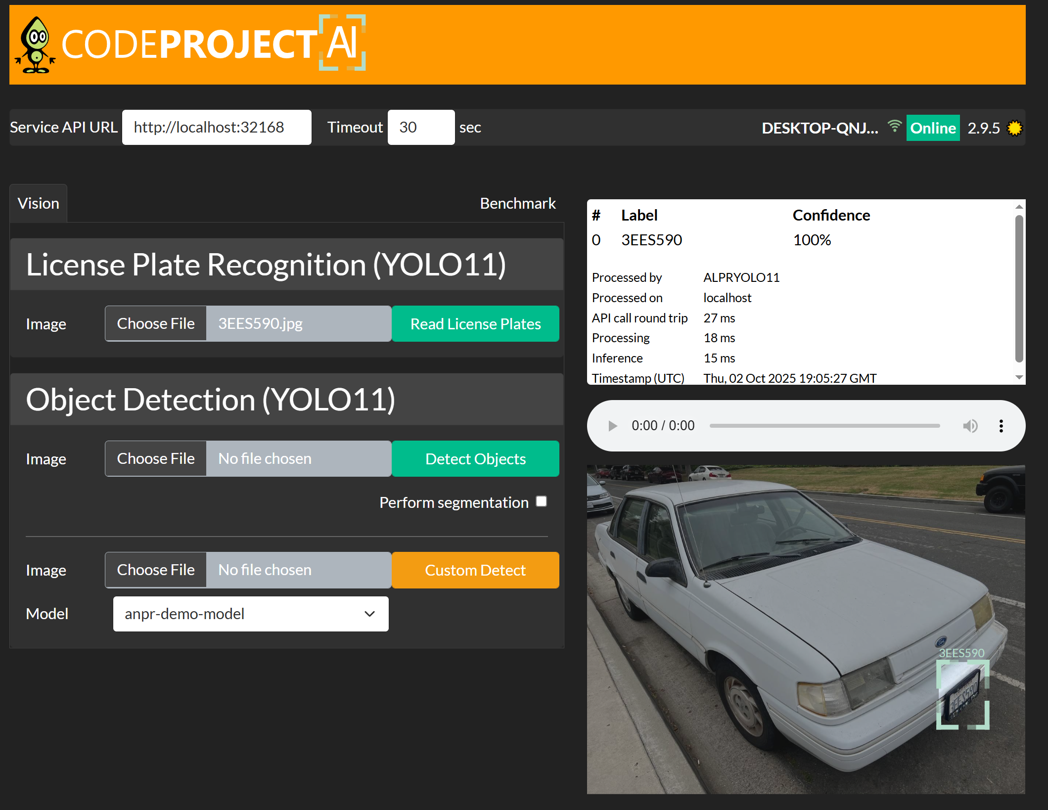

I have been working on a totally new ALPR module based on YOLO11. I have been running in parallel with the current ALPR module and I am see better results, below is one example that the old ALPR could not read the plate also Plate Recognition could not read the plate. The new module are using all ONNX models that I trained. The ONNX model are fast and can work on Intel iGPUs. This new module I am planning on adding vehicle color, make model and also State recognition . I am think of creating a patch for CP.AI that will allow users to install new module using a GitHub link
WOW! Can't wait to see this. The vehicle data (make, model, year, color) would be super helpful!
