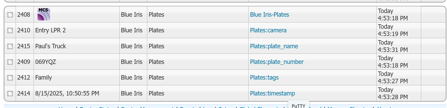

1) The payload should be sent like how Blue Iris sends things. For instance { "plate_number":"&PLATE", "Image":"&ALERT_JPEG", "camera":"&NAME", "timestamp":"&ALERT_TIME" } comes across as multiple payloads under one topic and sorts nicely on my home automation system. As it stands I cant tease out the data I want on the single payload.

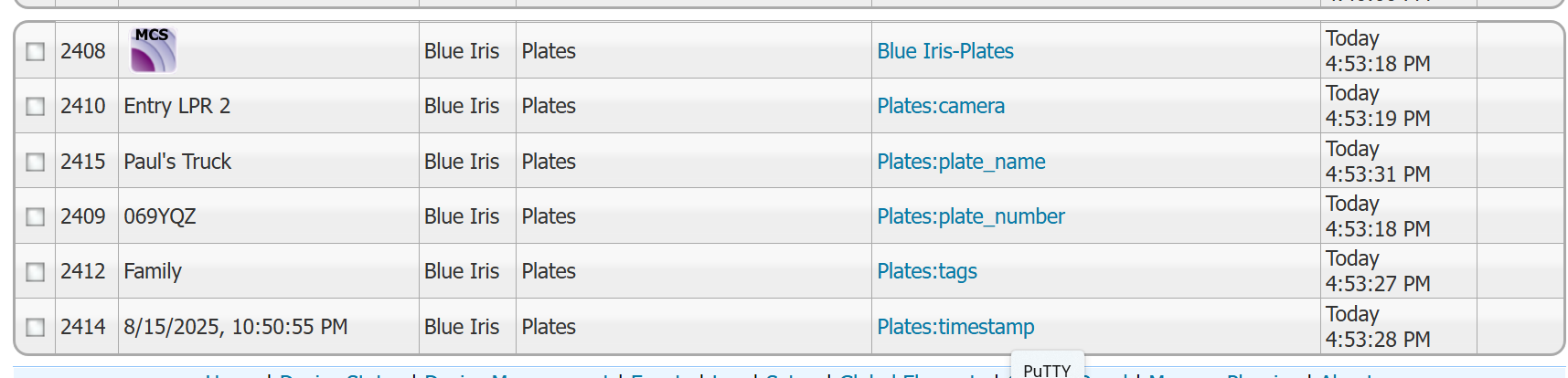

This is now working great. I have each data point coming across as a sub topic
One point that was mentioned before: The time stamp is wrong.

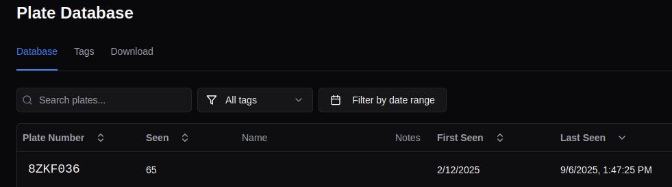

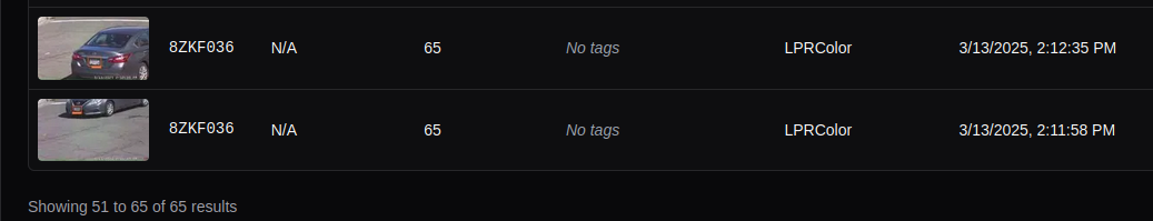

It does look like it is missing from data. If I look at the database and filter by date, you can see the oldest plate recorded is back on 2/12/2025

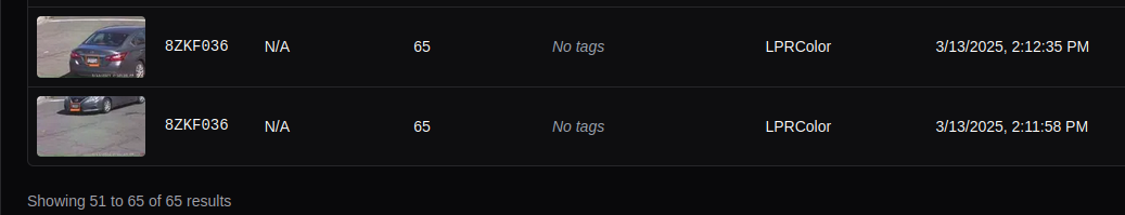

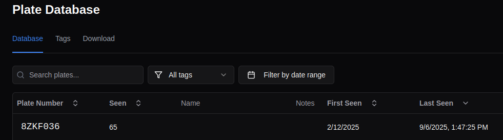

When I click into it, the database shows the old read of that plate is 3/13/2025. Where did the older reads go, like the very first read on 2/12/2025.

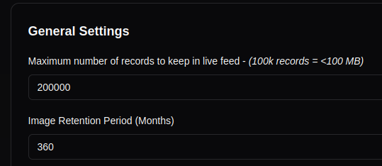

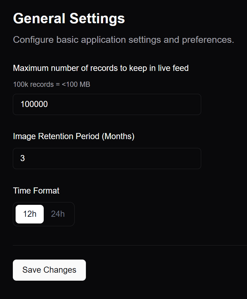

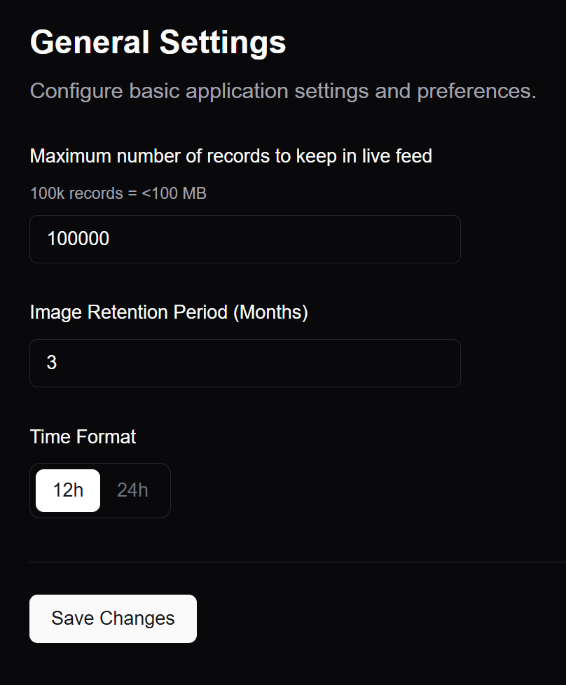

What are you General Settings, see my settings below
Mine was 100000, and I just changed it to 200000, the retention period has always been 360 months.

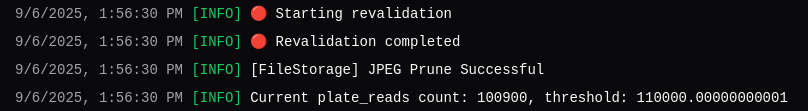

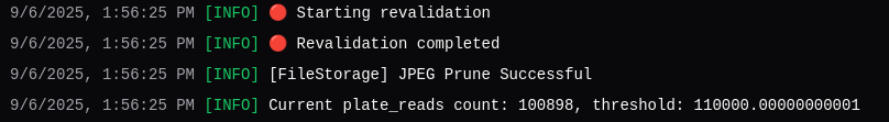

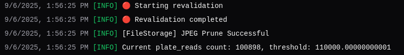

From the logs, it looks like it was doing some JPEG prune (not sure if that is just the actual file prune, or if it also prunes the entry in the DB). This was the reason I just bumped the max read to 200000.

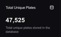

Mine is set to 200K and I have 47K + records. Retention is set to 12 months. Not sure why you would want a 30 year retention period.
