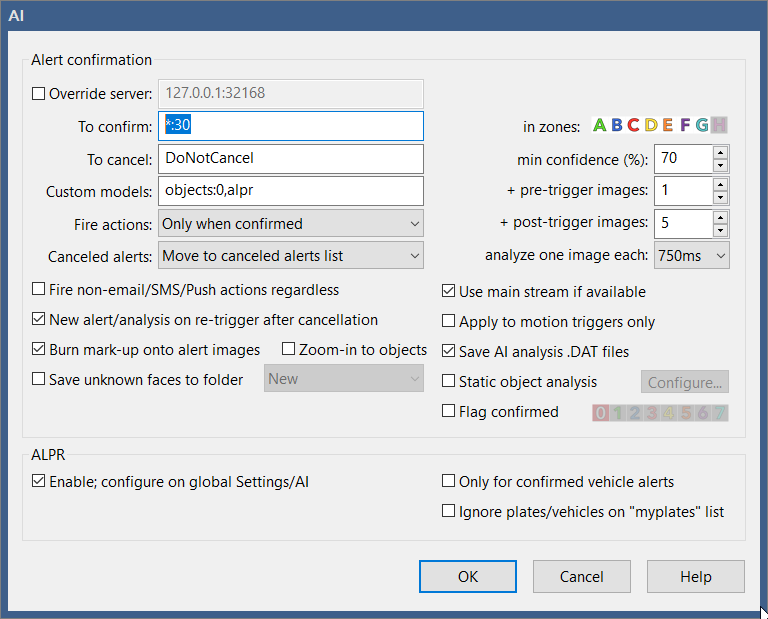

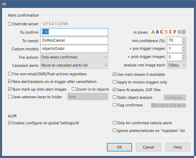

Then make sure your AI Configuration, under AI settings in BlueIris are set to this, and it worked for me! Whew...
