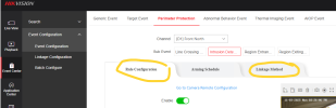

To enable or disable the "Surveillance Center" notification, which HTTP PUT should I send without modifying other parts?
Sending the above strings strangely overwrites the "Area Settings" previously configured by the camera because the draw areas set by the camera have more points than those of the NVR.
Are you sure that is happening? The "Area Settings" are on a different tab/page... are you also possibly using ISAPI to toggle "Enable"?
I see that toggling "Enable" on/off with ISAPI can cause the draw area to be reset... Here is what I see being sent in Wireshark when I toggle "Enable" on/off and hit "Save" (<enabled>true</enabled> for on, <enabled>false</enabled> for off):
What model number/firmware version is the camera? I suspect it's a newer model camera... I think the NVR firmware has not "kept up" with full support for this newer camera...
No, By changing "Linkage Method" on NVR, "Area Settings" is also overwritten, perhaps because even if it is part of a different tab, the page is saved only once.
Yes, the camera is newer than the NVR
Device Model DS-2CD2387G2H-LISU/SL
Firmware Version V5.7.17 build 240606
I don't see that happening on my NVR...

Here's what I see using Wireshark when I hit "Save" on the "Linkage Method" tab (you can see the "FieldDetectionRegionList" is NOT being sent):
Code:
<?xml version="1.0" encoding="UTF-8"?>
<EventTrigger>
    <id>FieldDetection-1</id>
    <eventType>FieldDetection</eventType>
    <dynVideoInputChannelID>1</dynVideoInputChannelID>
    <EventTriggerNotificationList>
        <EventTriggerNotification>
            <id>center</id>
            <notificationMethod>center</notificationMethod>
        </EventTriggerNotification>
    </EventTriggerNotificationList>
</EventTrigger>
It may be different on your NVR/firmware... I think you need to check with Wireshark.
