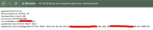

Hi everone,
I'm have one ANPR camera Dahua ITC431-RW1F-IRL8, the camera have running older Firmware and I have Download last Firmware at dahuasecurity page but can't upgrade for my camera. I have try using do like to see the camera cpu and what the page show. Does anyone have problem like me?1769187996314.png

Upgrading an OEM Dahua device with a firmware bin file starting with 'DH-' won't work as intended. An OEM device should be updated with firmware starting 'General-' . E.g. General-ITC_v5.0002R{YYYYYMMDD}.

Hi, this camera I have buy From Dahua DSS North Vietnam, they don't have provide me the newest Firmware like Version 5 to upgrade so I decided to asking everyone to help me about that Problems
