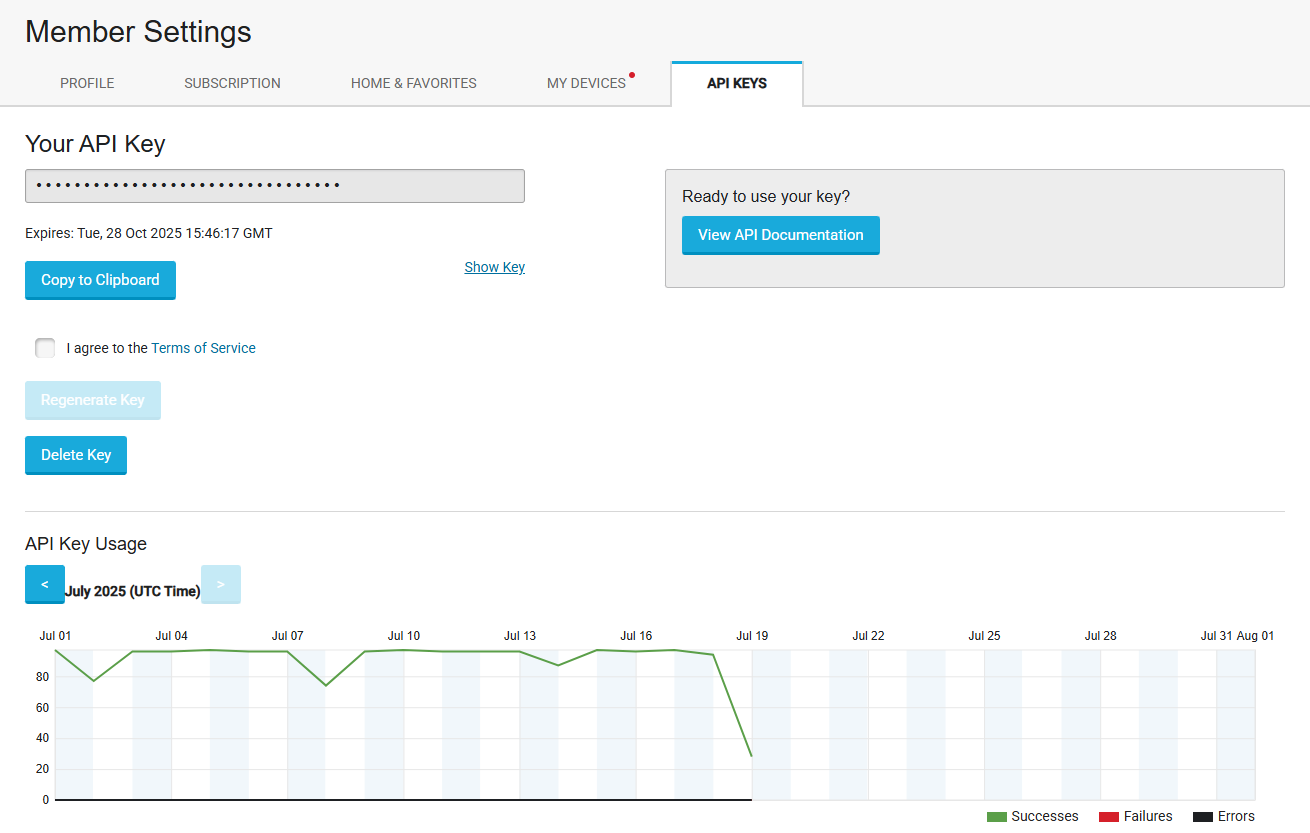

Per this ChatGPT answer, the API limits are 1500 calls per day, and 30 calls per minute.
You can view your usage -- by API -- at the following link. Click the 'Show Usage' button (lower left).

It will show a chart like this
Reactions: looney2ns
BTW, on the screenshot in the previous post, I've just noted an upcoming "Expiration date" for my API Key (10/28/2025)..
I don't recall a notice of this when signing up. This is ~6 months from when I received the key (4/25/2025).
Anyway, I've set of up a calendar reminder. It will be interesting to learn if I can renew the API Key, or need to generate a new one.

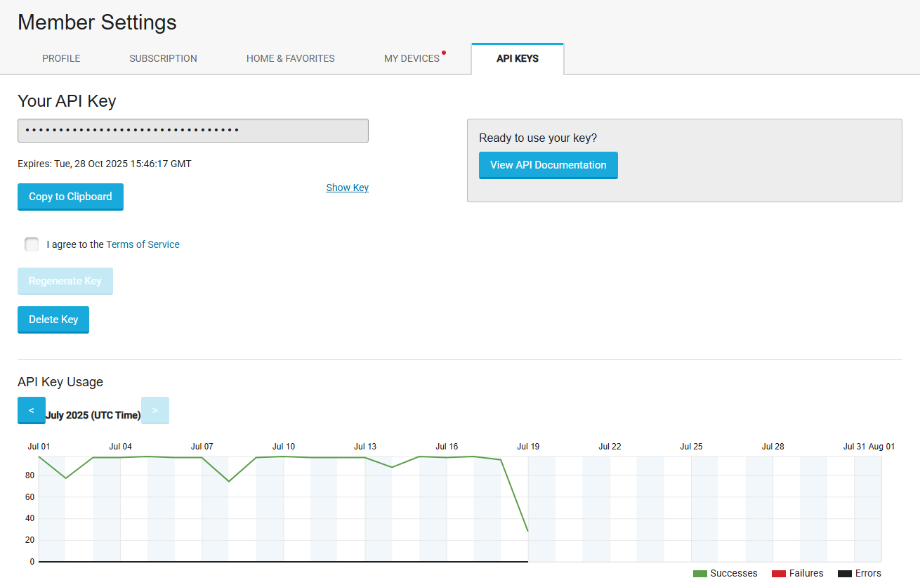

Login | Weather Underground

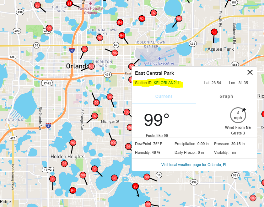

I'm surprised you have it working at all without uploading data to Wunderground from a weather station. It literally says on the link Using Weather Underground (WU) that you provided, "If you don’t own a physical PWS, the generated PWS will not provide valid data. Do NOT use this PWS for weather adjustments."
Go to the map then zoom in on your area.
Pick one of those stations near you then get the Station ID then plug that into BIT along with the API Key you created.

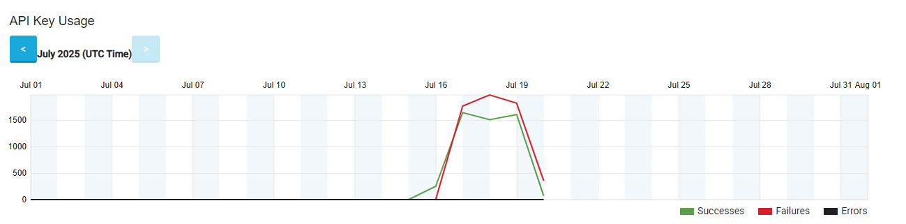

Did you check your WU API key usage chart? Just wondering if ChatGPT is correct about the the 1500/day daily limit?
Reactions: Sybertiger
You were correct! As soon as I hit the 1500 limit the failures began. Again, it was because I was sharing a key between two BI machines and updating every minute on both of them. I've gone back and created a unique API key for each BI machine.

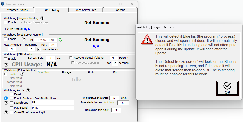

I've got a 14900k CPU, but Blue Iris Tools is a really small program and doesn't even register above 0% CPU and around 20MB or RAM in task manager most of the time, even with a watchdog enabled and having it do the write the text values to overlay macros. Occasionally it will spike at like .6% CPU, so it's most likely negligible to the performance of your machine especially when compared to Blue Iris itself
There are multiple watchdog functions, it might be what you are looking for. It shows you can do email, but I haven't tested that. It's easy enough to download Blue Iris Tools and play around with it. If you click on the question marks in the UI, it does a pretty good job of detailing how each watchdog works.
