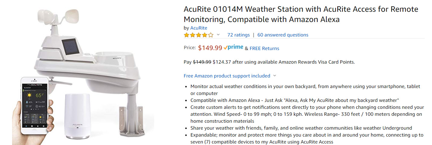

I was looking at them a year or so ago online..
Shop Amazon.com | Weather Stations
I have this one - Accurite 5 in 1. It comes with different options, but I did not need or want their 'desktop' display unit. I bought it with their 'hub' which can upload the data to Weather Underground and you can also view the data on any computer or laptop with a webpage. The hub connects wirelessly to the 5 in 1 and then to your network via an ethernet cable. (My hub is on the ground floor and the 5 in 1 is on top of the chimney of a 2 story house). You can spend a lot more money, but I have been pretty happy with this one. I first got started with My Accurite because I bought one of their thermometers that had 3 wireless sensors that I could place around the house and I was also able to use them with their hub
Reactions: Jessie.slimer
