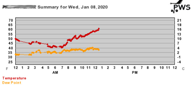

I am using a workaround for my Rachio Sprinkler controller that someone came up with and it still appears to be working
The problem was my personal weather station that I wanted to use for 'smart watering' can only upload data to Weather Underground. But, the Rachio can not use Weather Underground stations. So someone came up with a chron job using a free website that copies the data from Weather Underground over to another weather website - pwsweather.com that the Rachio controller can use. As of today, I am still getting updates every 5 minutes from Weather Underground

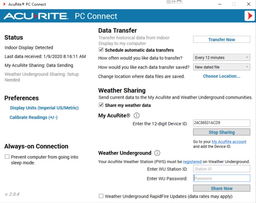

Hi Mike
Appreciate BIT very much, thank you for the tool. In regards to weather integration I use AcuRite PC Connect. Would be nice to have a option to use that. See screenshot.
Thank you
