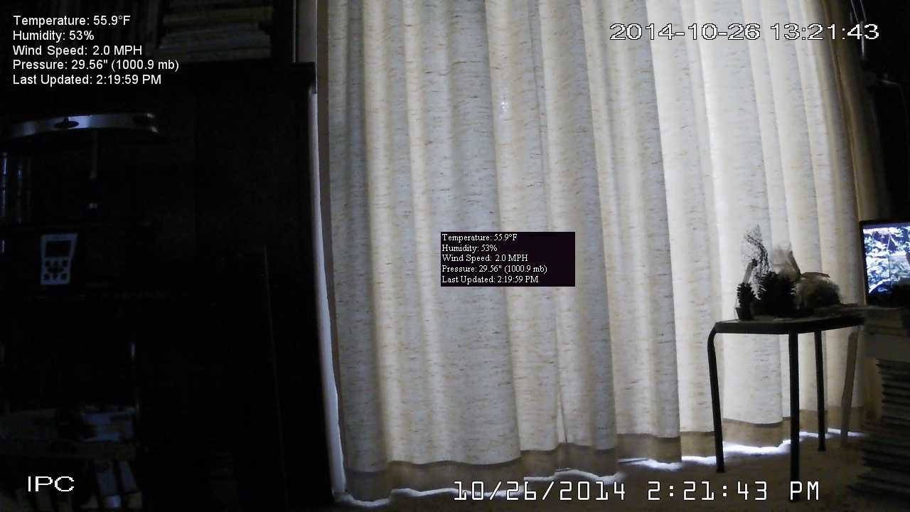

I got it working for my camera which will become a weather cam for my Weather underground PWS. It looks good. My only problem is that in the process of setting it up I got an overlay on the screen that I can't make go away. I suspect it is just a residual macro file someplace. Could anyone tell me where BI stores it's overlay text?

I appreciate your response. And, I have tried the methods you suggest. However, in this case, it does not work. The overlay in the center of the screen does not respond to the right click when I try to edit the BI overlays.
I am reasonably sure that I caused the problem by opening and saving a new overlay without clicking on and clearing the previous one. In any case, what I wanted to do is look where the macron are stored and see if I can locate something there that is causing it. As a last resort I could delete the camera and create a new one.
I have included a snap of the screen. The image in the center is the unwanted on. I notice that when the good overlay in the upper left corner is updated the bad one is updated also.

Sometimes you need to click all over the area of the text for the dialog to come up...worst case do as you say and set up a new cam...

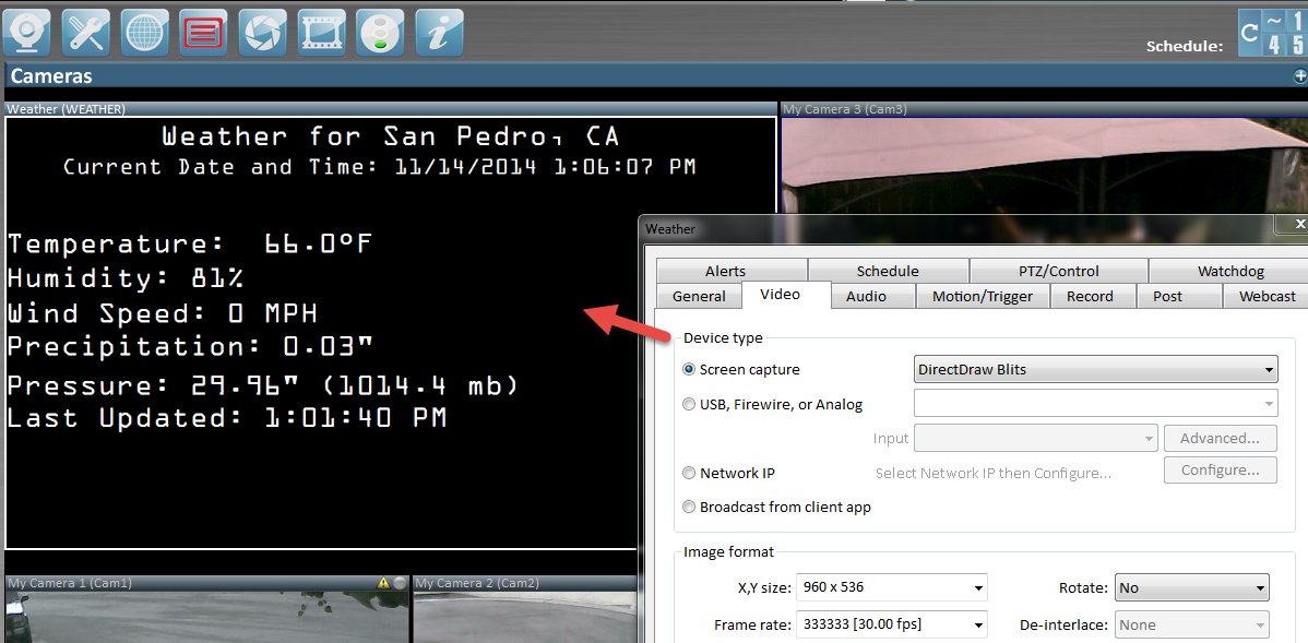

To the one person that was asking about how to make a BLANK Camera to display only weather stuff.
Try this:
Create a new camera, and point it to "Screen Capture" --> DirectDraw Blits (for me it was black screen and worked)
then add your Macro list to it...
attachment.php
