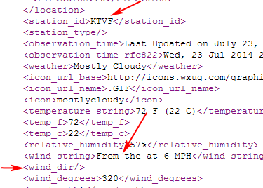

Thanks for BIT. I'm having the same trouble as poster #33. "Wind Desc.: From the @ 15 MPH, gusting to 18 MPH". Using KTVF. But tried KGFK, KFAR, KRRT, KROX. All the same, no wind direction. Any fix for this? thanks
Thanks for using BIT. Unfortunately this is an error with wunderground's weather feed, it is not reporting anything for wind direction for any of those stations. I've attached a screenshot from the station KGFK. Unfortunately since there is nothing being reported for wind direction there's no way to get it from wunderground. What I can do though is program in a conditional to look for a null value, then bypass the direction part all together. I'll also keep thinking of other ideas and if anyone has any I'm all ears! :)

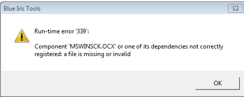

I install BI (with 1.0.1 installer) on Win7/64 as administrator. If i try to start the prog i get tis message
Any ideas on why this happened?

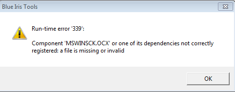

Hi community;
Download and extract the files in error-files only for issues.zip (in the first post) into your BIT directory. Let me know if that resolves it.
@Mike
doesn't work with issues.zip same message.
@wxx13, open up command prompt in Administrator mode (click Start, type cmd, then right click cmd.exe and select "Run as Administrator". From there type:
Code:
REGSVR32 "BITpath\MSWINSCK.OCX"
Then see if you are able to open BIT. If it still doesn't open, try what I mentioned above but with C:\Windows\SysWOW64\ as the path instead of the BIT path (unless your windows path is something else, then substitute it).

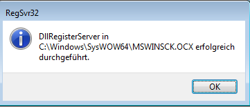

@Mike
I have try this
Code:
REGSVR32 "C:\Windows\SysWOW64\MSWINSCK.OCX"
and get a message that the DLL is registered
Then i try to open BIT and get this message
Any ideas ?

Did you try registering the ocx file in the BIT directory? If so, try copy pasting the ocx file in the BIT directory into win\syswow64, then register it again.
@Mike
thank you for help. With you instructions nothing happened.
Problem solved ! I activate the Admin Account and logged in. BIT is working. logged out as admin and logged in as normal User
and voila' BIT is working.
thank you.

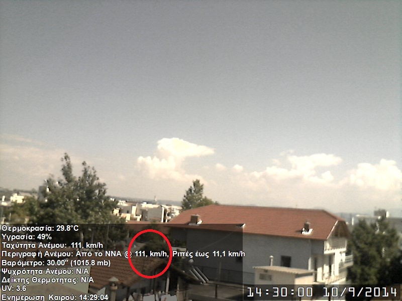

Hi guys ......
I use this a lot of useful application here : http://www.sv2bzq.gr/webcam/
But I have a problem .
ιn option " wind " displays it wrong ie writes 111 while the right one is 11,1 As you can see in foto :
Any idea ?
