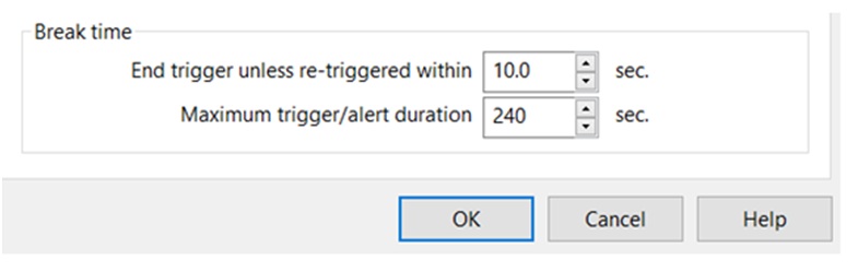

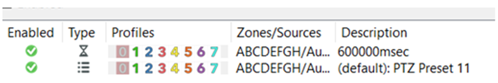

So I have noticed that some people have had that issue. It is supposed to go back after the break time maximum duration. Mine works as intended as does it for some, but I have noticed some recent folks setting up it doesn't.
So what you can do as a workaround is go into the alerts and add a wait time for the duration and then tell it to go back to the preset.

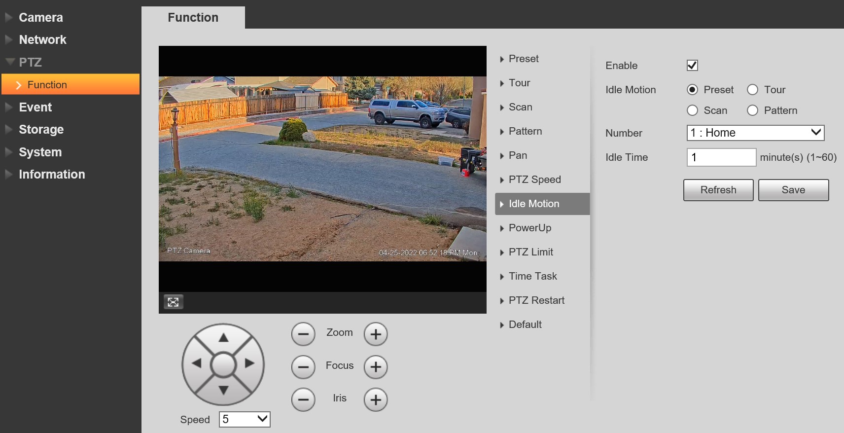

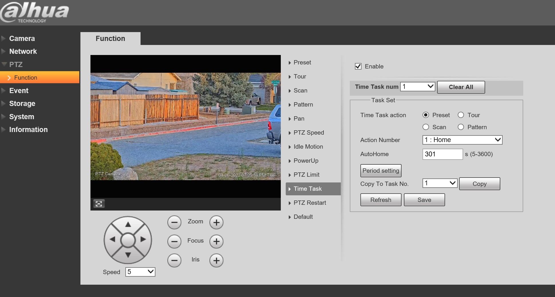

it appears I am in error. Though "logically", the PTZ/Function/Idle Motion "should" move back to a specific preset (in my case...Home) after an idle time of 1 minute... that only happens rarely as in not consistent. I do not know why. I wonder if this interferes with my Blue Iris MAKE settings or some other settings. Or if this relates only to the Motion Detection of the PTZ itself (which is turned off due to using IVS rules).
But was does work 100% of the time is a different menu option. Time Task. After 301 seconds (301 because I have auto-tack on for 300 seconds), it will goto the preset I enter. I'll have to play around with all these settings but at least I found an easy way to reset the PTZ to HOME present.

use that 'time task' menu. it works (at least for the last 24hours). More testing to be done.
