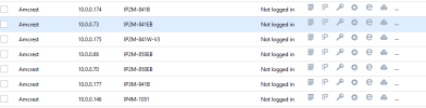

Please note there are in fact a POE version of the 841, They are rare but I do have 841E, and a 721E as well.. So if you happen to find a POE version it will be with the note of such.. As you can see in the picture below, 841EB is POE Black in color camera..
