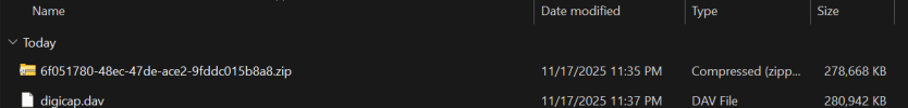

Strange result... current by S/N is older .800 version with a newer release date?
I have the firmware downloaded but I can't attach it here or on the PM... from ipcamtalk.com I'm getting:
PM me your email address and I'll send it, or if that doesn't work I have a Dropbox account I can load it to...
