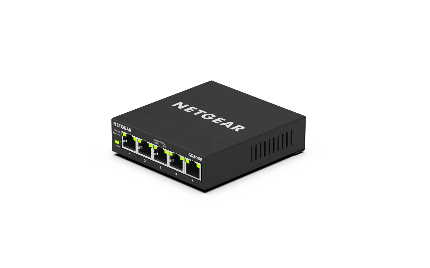

What do you consider high wattage? I have an incredibly modest fanless VLAN capable switch for IPC's which I picked up back when I started this journey, and it's only a 4 port but has a 120W budget. You can cycle a port's power without losing PoE to that device downstream, test for shorts, and loops etc. At the time all I cared about was decent wattages, an intuitive web UI, and that it was basic, and advanced VLAN capable including 802.1Q (basic/advanced) so it could continue to serve as my network grew. I guess, in your case, it would also matter where the switch is physically (in which building), and whether something like this would play in your ecosystem.
Yep, I have two of those, got them a couple of weeks ago when Amazon had them for $30 off. :) One of them is running a couple of cameras including the 49225 PTZ which is the highest power demand I have.
Well, I cancelled the order on the 24p. I'm still leaning toward the OMADA SDN feature (only because I have some of the pieces now), But that little NetGear above,is tempting IF it was on sale. To replace my failing switch would take a BUNCH of them. The good news is that my failing switch is working for now and since I was able to cancel the other, I now have the option to take a better look around at what's out there. Maybe three 8p switches or two 16s.
