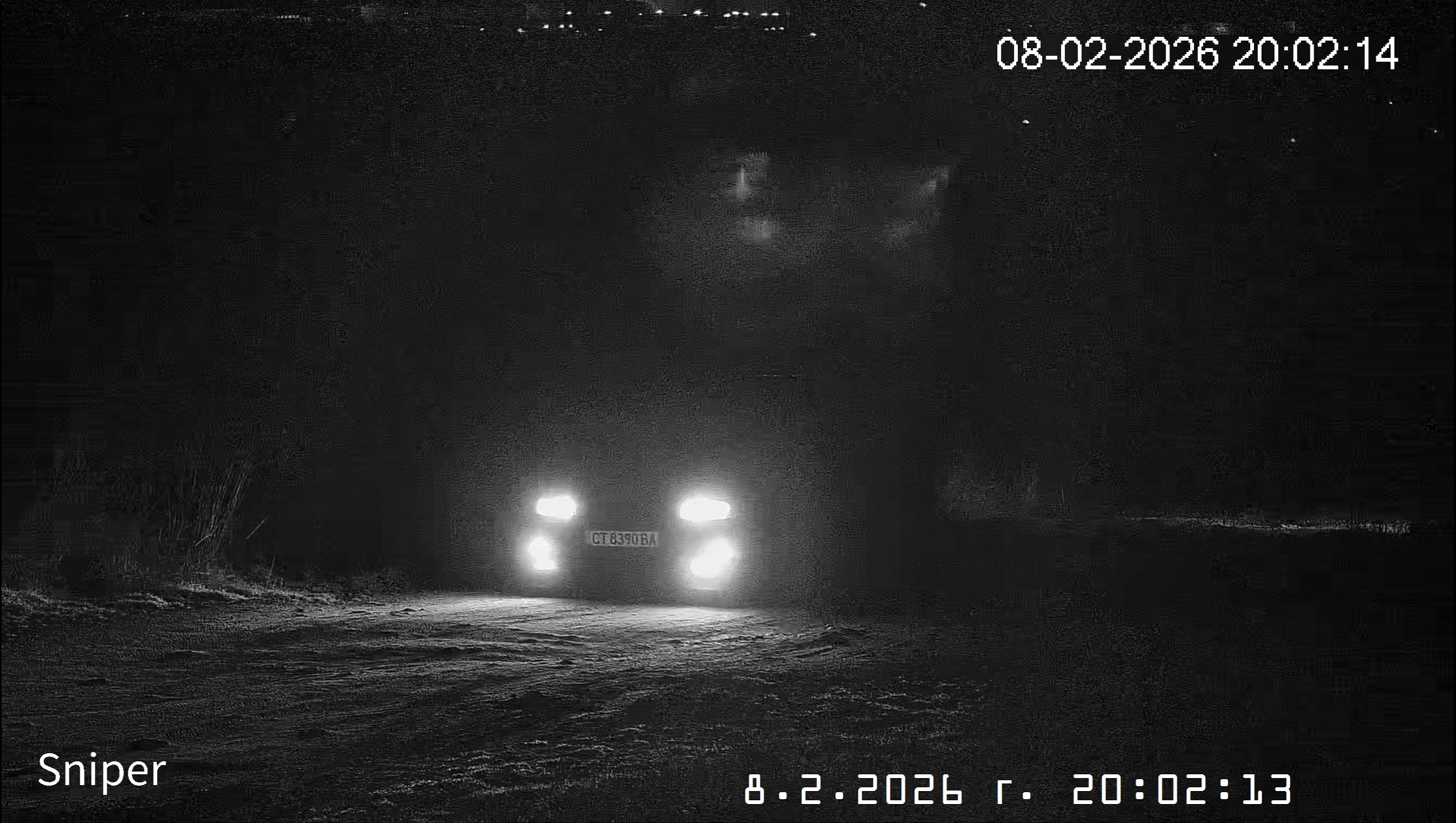

It's a dirt road at the end of a neighbourhood with mostly pedestrian traffic, however cars do come ocassionally - they don't drive fast though like 20-30km/h (12-20mph) at most and they drive towards the camera at a very slight angle. Still night pictures for LPR are very good, here's an example that's like 30 - 35 meters (100-115 feet) away from the camera. It is taken from a screenshot from the video footage and the car had both high beams and foglights on, so extra bright. I have not tested it at night for movement but it seems pretty good with self-adaptive - what I need is to get a closer overview so I can still see something while no cars pass by (which is very rarely especially during night). I do have 2 other cameras that look at that area but they are not that zoomed - one is a standard IPC-T54PRO-AS, the other is a zoomed up IPC-T54PRO-ZE - however it looks through a fence and its zoom is not that close as the Z4E and I don't get much detail at night.

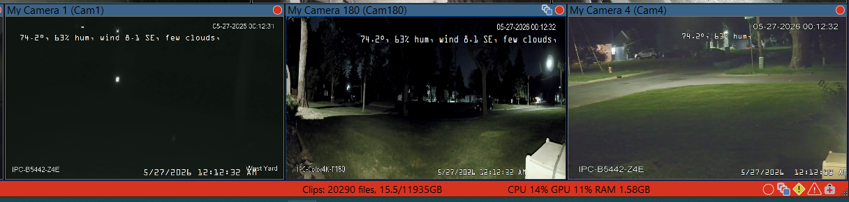

The middle camera is a 180degree cam overlooking over the Z4's, of which one is setup like LPR.
