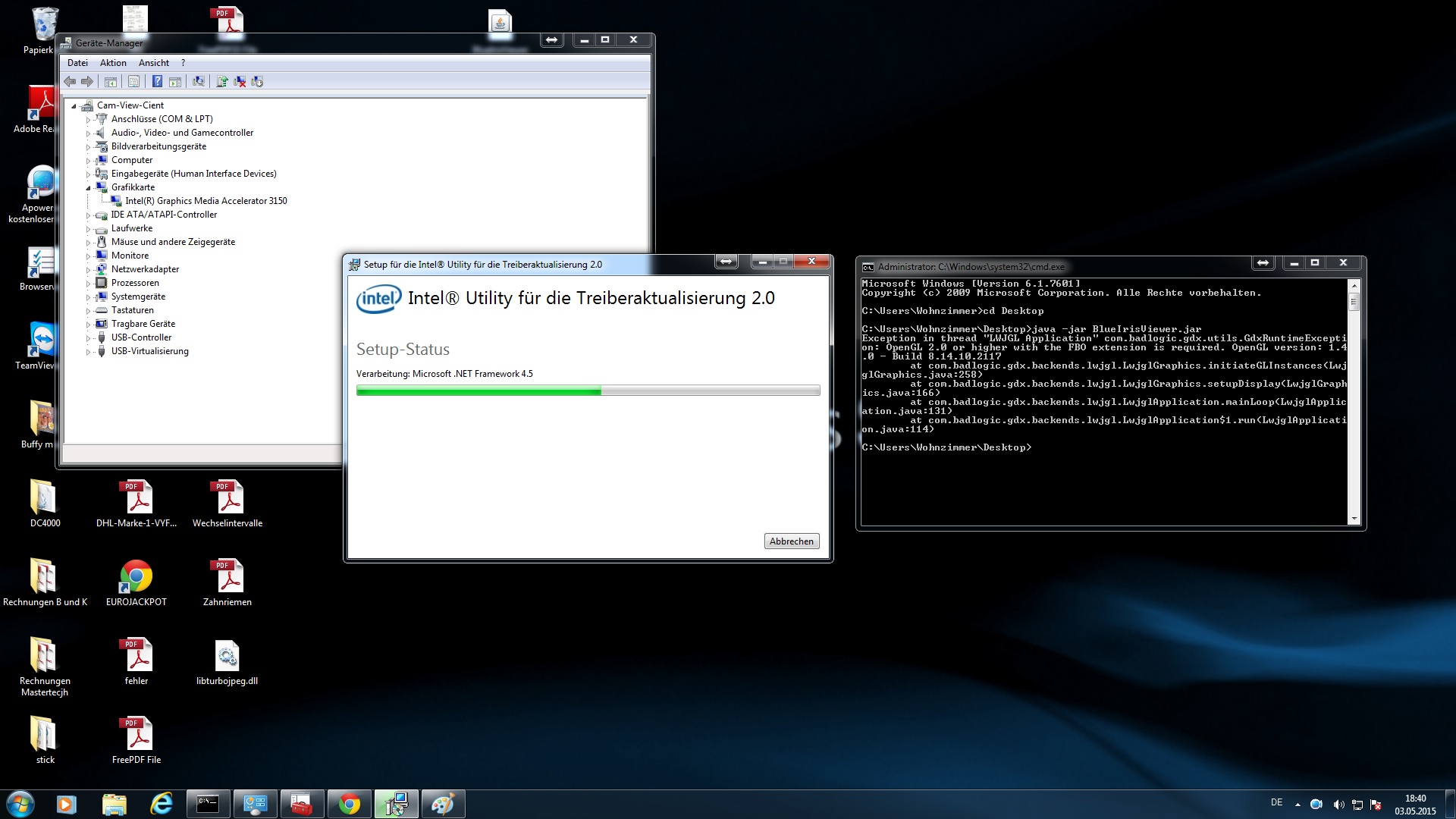

Ok, here is something you can try:
1. Copy the jar to your desktop, and run it from there. (there are usually fewer write permission problems on the desktop)
2. If that doesn't work, hold shift and right click the desktop, and choose the menu option "Open command window here". Run the command:
Code:
java -jar BlueIrisViewer.jar
And maybe the command window will contain hints as to why it is crashing.
Yes This was a good Solution THank You. Now in Attachment i have the Screenshot.
OpenGL Problem. I have install the latest driver but there is only OpenGL 1.4 Support
attachment.php
