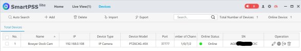

Fixed the cable, but since the pushbutton reset, SmartPSSLite remote access doesn't work. I'm not sure what to reconfigure to get it working again. Remote access still works with the DMSS app.
Now the camera is found by SmartPSSLite only when I'm on the local network, not when trying remote internet access (error when on remote internet access is "Can't find Network Host").
When accessing Smart PSS Lite "Devices" locally, it shows the camera setup with: correct local IP, on Port 37777, has channels 1/0/7/2 and has correct serial number and password.
