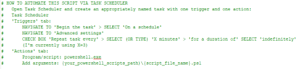

STEP #4
Automate the script from Task Scheduler.
