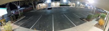

Does anyone have night footage for PTZ3E10X-T180? I am trying to find if it will work on one side of my house where I have no other cameras and no coverage at all. Anybody knows the corresponding Dahua model for PTZ3E10X-T180 ?
Granted... good external lighting due to being in business plaza.
I have one of these models for home, but not yet setup.
And I would not consider this a MAIN camera to rely on solo on a side of the house. Night time at a distant (DORI) I would not expect to be all that great. The 180 + PTZ is nice but has it's limitations.
You would want a T54I model as MAIN camera. This 180 + 10xPTZ as auxiliary camera.

I changed the intrusion line to a zig zag accoss the area, and i got to say the PTZ started tracking people alot better,and stayed consistently with them as they crossed the multiple lines..
Those lines are still terrible, I'm surprised you capture anyone. It will probably miss people not on the pavement nearest and even then I'm surprised it triggered on those. If they can pass behind the lines, they won't trigger it.
They need to be grounded. You're still thinking 2D. eg. I'd draw them to the 1/3rd way up the lawn of the house opposite to give them depth and ensure they're low down. Maybe even lower. You also need horizontal lines the full width of the picture to ensure no-one walks past the ends. Knee height is always a good recommendation.
