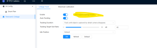

Just got the PTZ3E10X and like it a lot. Has anyone been able to get autotracking to work on an IVS rule-by-rule basis? I have a single IVS intrusion zone on the panoramic cam on a golf course fairway near my house that I would like the PTZ to autotrack when a human appears in that zone only. I have other intrusion zones and tripwires on the pano cam that I do not want to have the PTZ to autotrack. I hope I'm missing something, but autotrack seems like an all-or-nothing deal with the current firmware. Anyone had success getting autotrack work with a single IVS rule when you also have other IVS rules?
