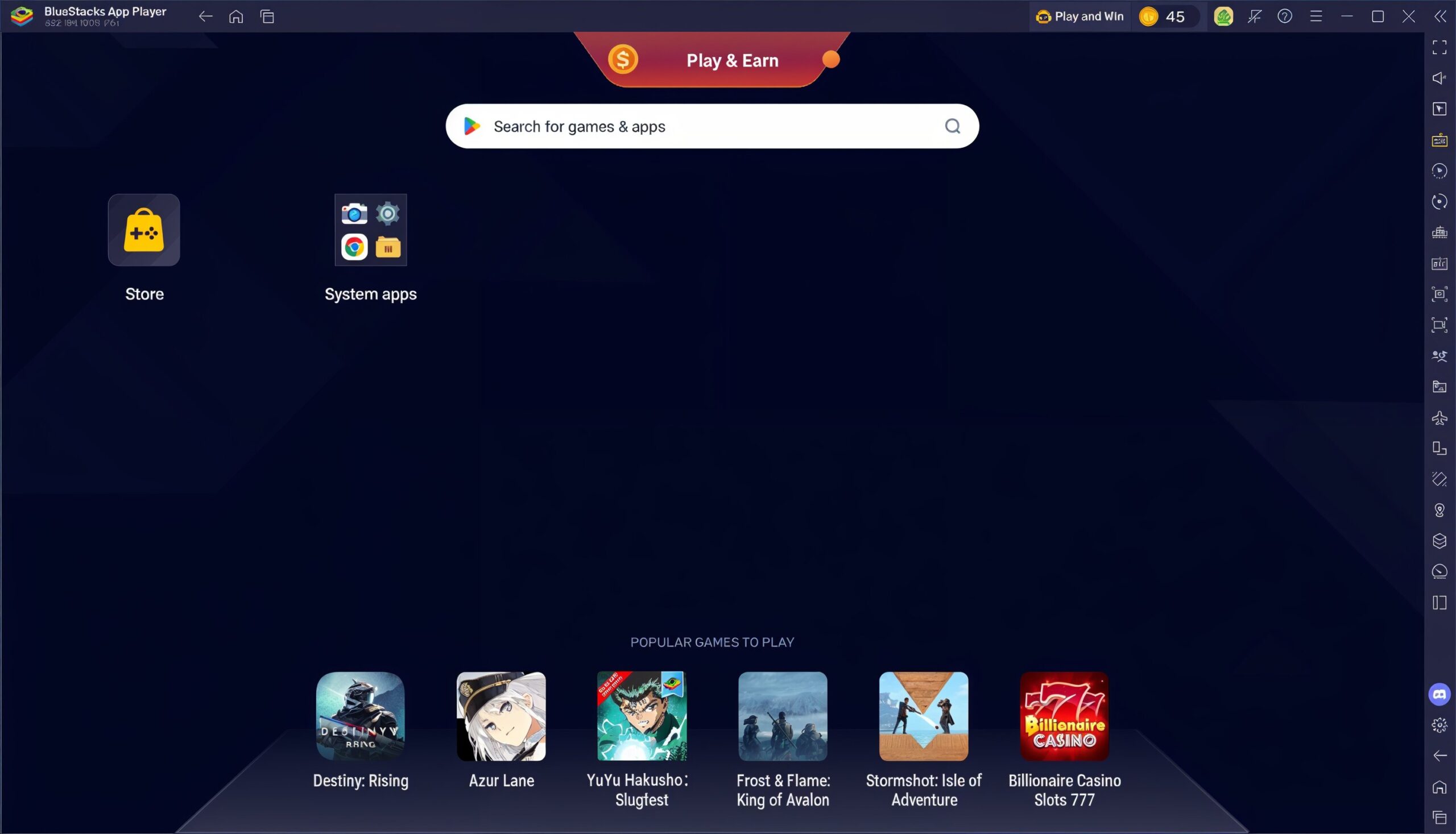

I am thinking android because... you actually don't need a device. You can run it in a virtual machine on a PC... And on the same PC setup wireshark so you can see the packets go in and out from the android app.
I did this a while ago. Had to refresh my memory.
