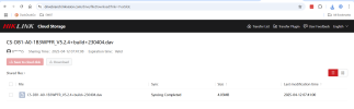

Hello David L! Thank-you for your brilliant suggestion. TLDR: The result is "HOW TO INSTALL FIRMWARE ON EZVIZ DB1 (POSSIBLY EVEN IF IT IS BRICKED) USING ONLY THE SD CARD"
So I did what you suggested, and got this very nice letter back the next day:

Regarding the issue you have encountered, please try to update the firmware and see whether this might help. To upgrade firmware, you will need to prepare an empty SD card, an SD card reader and a PC.
1. First please insert the SD card into the SD card reader and connect the reader to your computer.
2. Log in your email box on your computer, visit https://drive.ticklink.com/hcs/controller/hik-manage/fileDownload?link=7voiSloE& (password: 625z) to download the firmware package and save it in your SD card (When saving, please change the file name to "ezviz.dav").
3. Power off your EZVIZ device, take out the SD card from the reader and insert it back to the camera.
4. Power up device again, and then wait for 3min it will complete the update process automatically.
(If the SD card remains in the device, kindly take it out and ensure to delete the firmware before reinstalling it. Please be aware that upon successful firmware upgrade, the firmware will be automatically removed from the SD card.)
If you have more questions or require further assistance, please let us know. We would love to help.

Anyways, in the meantime, we now have a .dav file of the latest and greatest EZVIZ DB1 Firmware (that does NOT support ONVIF) which was what I originally asked you for - Yay! :)
By the way, this is the exact same version that the EZVIZ phone App asks you to update to if you let it.
As you predicted, HikVision and EZVIZ are one and the same. The file download site sent to me by EZVIZ support cinches the deal. (Attached photo)

I do not add the user under the ONVIF configuration. I add it under the system user section.
Thanks pete_c. That worked on F/W 211101. Photos attached.
By the way, what do you mean by "I do have it registered on the bottom section of batch configuration" ?
Reactions: David L
Yes contrary to the documentation I have the doorbell registered in the bottom section of batch configuration.
