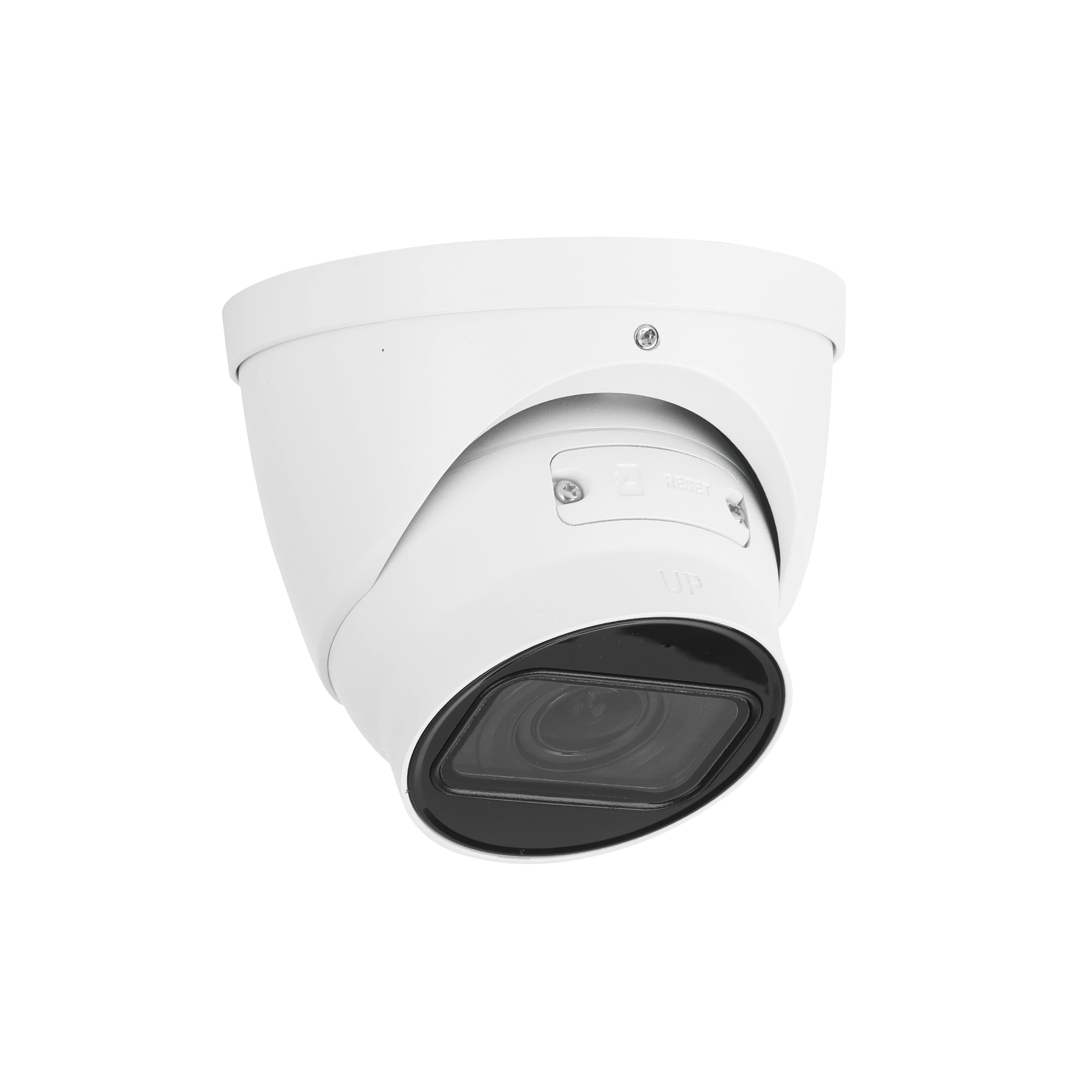

That one is sold out everywhere.
I searched for "IPC-T3241T-ZA" on empiretech01.com but its not listed at all.
The only 2M cam I found here is this:
Is this the same quality?

Yeah that would be the newer model.
EmpireTech is not listed as a supported brand for my Synology surveillance station software. but DAHUA is. I can't find the DAHUA equivalent model number to "IPC-T22IR-ZAS S3" in the list. Do you know what the DAHUA model number is?
Also, DAHUA got banned for spying, much like Hikvision. Can those cams potentially access all LAN traffic, or only be used to transmit the stream?
Andy, EmpireTech sells Dahua OEM cameras .. name has to be changed to reflect the branding needs of Dahua .. the model number should be easy enough to match to Dahua Internation models. ( not, Dahua USA as they only carry a smaller subsection of models )
Synology and other VMS products typically only have a subsection of camera models ..
in terms of Dahua getting banned .. and Hikvision .. it's more than the question of "Spying", and it gets a bit more nuanced .. in general, for all IoT / including security cameras - plan to isolate them somehow. This includes the smartTVs you have .. and lightbulbs .. just a question of time when they get cracked ..

Little update on those 4 dome cams with IR leakages. I cleaned the glass and added some foam.
The IR reflections are gone. :) Saves me 600 bucks right there. Thanks guys!
For the one dead indoor cam I ordered a VIVOTEK FD9369-F2 because all the VIVOTEK cams I own, have lasted 10 years without a single issue. They are also made in Taiwan and don't come with the risk of backdoors.
Now, I still need to replace 2 outdoor cams, and in this case I want bullets cams again. VIVOTEK doesn't offer bullets cams with microphones so I may try a EmpireTech IPC-B22IR-ZAS S3. They are on sale at Amazon for $128. I think I'll order one and test it within my Synology Surveillance Station, packet logger and all.

Thank you. This will be a weekend project. I just order that EmpireTech IPC-B22IR-ZAS S3.
