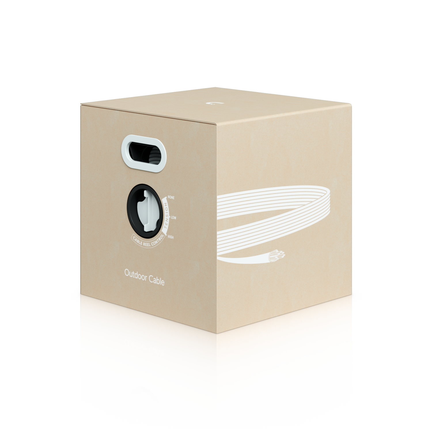

Is this Cat 6 cable any good?

Amazon link is bad
It is a reputable company and is sold in the North America by Lowes and Home Depot at higher price. All cat6 has the inner core and is not hard to handle. Doing tight bends is BAD for any ethernet cable. Ignore that 1 comment about it being hard to bend.
The price is good also.

Just be diligent when purchasing the male RJ-45 connectors..... be sure they are for 23 AWG and for solid conductor.

Sometimes if you're running additional Cat6 cable though an already existing access hole without much clearance due to other cables passing through, that Cat6 inner core can be the make or break different between whether that cable can fit though the hole or not. In those rare cases and assuming you can't drill a new adjacent hole I revert back to Cat5e cable which has no inner core so it's a smaller diameter and will usually fit through a tight space.

Do you need or want shielded cable?
I should have been more wordy, did you notice the cable you linked to is shielded?
I'm far from the expert on shielding, and you may get more specific answers. My 30,000 foot take on using shielded cable is:
1. With twisted pair cable, it's rarely necessary.
2. Grounded and/or bonded incorrectly it makes matters worse.
3. Grounding and/or bonding correctly adds to the installation cost and labor.
